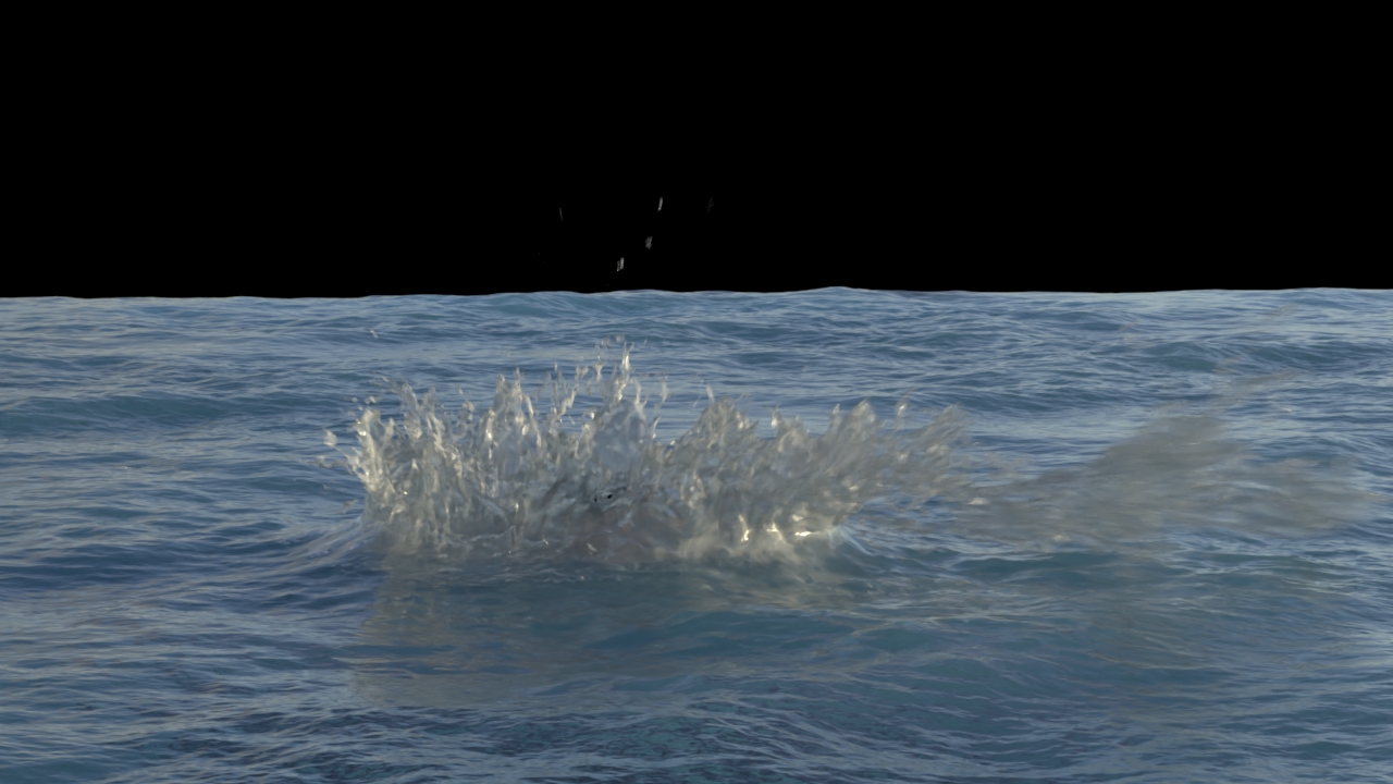

I have a water simulation scene that I originally created in Houdini 21.
After opening the same project in Houdini 22 and rendering the same frame with the same settings, the result has a very noticeable red/magenta tint.
I have already checked for missing textures, broken file paths, and issues with the HDRI, but everything appears to be loading correctly.
Has anyone encountered a similar color shift when moving a project from H21 to H22?

Hello chf,
I believe what you are seeing is the known "salmon effect" in ACES 2.0.
This happens because ACES 2.0 handles the path-to-white differently than version 1.x. It avoids harsh gamut clipping, but the trade-off is that highly saturated reds can skew into a salmon-pink hue under certain exposures. You might also notice a similar shift where Looking at an HDRI sun for example.
If this is the case, try to change the "View Transform" in OCIO from "ACES 2.0 - SDR 100 nits (Rec-709)" To "ACES 1.0 - SDR Video" <-- what Houdini 21 was using, If your colors are back and there's no shift then it's ACES 2.0 way to handle highlights.
Hope this helps you clean up the look.
