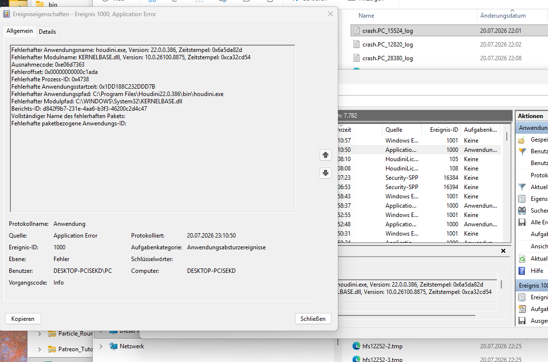

Windows Event Viewer Log:
Every time I launch houdini.exe, Windows logs the following Application Error (Event 1000):
Faulting Application Name: houdini.exe
Faulting Module Name: KERNELBASE.dll
Exception Code: 0xe06d7363 (Visual C++ Runtime Exception)
Faulting Offset: 0x00000000000c1ada
Has anyone encountered this specific issue on Windows Insider build?

I see on this page [superuser.com], another person is experiencing a crash with the same offset on the same version of the Insider build. It's possible there's an issue with this version of the OS.
Please note that Windows Insider builds are not supported.
