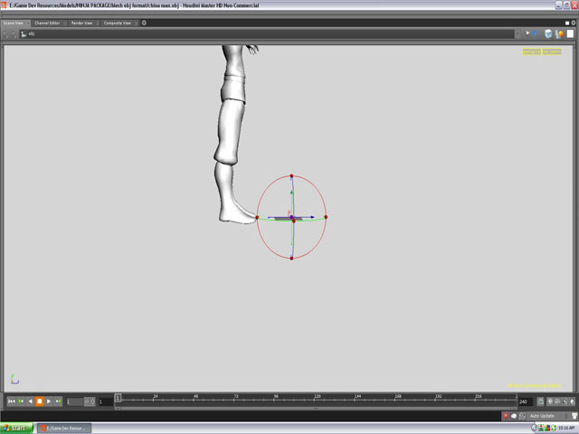

This is my first time using Houdini 9.5 and I have one question… I've imported an image made in 3DS Max into Houdini for the purpose of rigging and testing it in GG's Torque Game Engine. After importing him, the model seems to be “out of the center of his world.” How to I align him to the center of his world if possible. Attached is a jpeg image displaying the issue. Thanks!

Append a transform sop to the file sop and you can either manually position him, or you can use a local variable such as $ZMAX, $ZMIN to automatically position him.
Let me know if you need a more detailed explanation.

If it is not a problem, please break it down. The only 3D app that I've been working on is Milkshape 3D. I understand some things about transforming objects (through tutorials) but i feel that the mid set or the way I'm thinking is not what you're thinking. Sorry…
22 posts
Joined: July 2008
press “insert” to go to the pivet mode, then move the pivet…
return to normal mode (insert again)… and zero X Y Z… than it should be centered…

Try sticking down a transform node after his geometry
Enter the following expressions into the three translate parameters
-centroid(opinput(“.”, 0), D_X)
-$YMIN
-centroid(opinput(“.”, 0), D_Z)
This should center your character on the X and Z axis, and place him so that the bottom of his geometry is level with 0 on the y axis.

What Allegro said.
I've never used the centroid expression before. Quite a nice trick!
