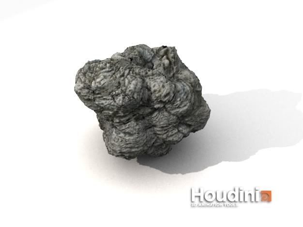

Try a sphere with a mountinSOP for the larger details, add a subdivideSOP, then another mountainSOP for slightly smaller details, and a displacement shader for the really small details. Add colours to suit.
Or even throw a fractalSOP into the mix, but be sure to use vertex and not points inside this sop of the result will be a mite unexpected.
