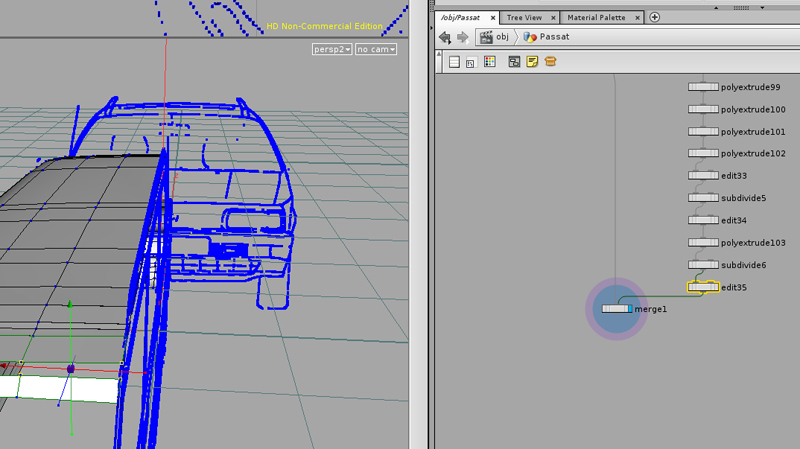

The special question I run into the problem that this is the first time I do blueprint modelling in Houdini. I think thats not easy but i followed a tip in the odforce forum where somebody uses the trace node for three or for views that are used for the blueprint. Yesterday I tried it the first time, and I liked it a lot. But the system felt slow (Q9650, 8GB, Win64). So I started again today with the second car. I just imported one sideview (pixelimage with a linedraw abstract of the car, 9 pixel linewith, stored in rat format) with one trace node. Then I saw that it is made out of 100230 Points and edges. Much more accuracy than I need for a blueprint. I tried to play with the filter options, but it was not really satisfying because there was too much damage to the general geometry. Then I tried to add the resample node, but it was not much reduction to the amount of points. Poly reduced doesn't help, too.
So its clear, I am doing something fundamentally wrong ;-)) Any hint to this current problem?

The special question: I think thats not easy but i followed a tip in the odforce forum where somebody uses the trace node for three or for views that are used for the blueprint.
The Trace SOP should be quite fast. I wonder how much detail your starting image has. It's best to trace images that have shapes with solid fills as you will then be tracing the shape. If it is just line work then the trace SOP has a tendency to trace the boundary of the line thickness and you end up with twice as many lines as you need. I wonder if that is the problem you are encountering.
The Resample Shapes option in the Trace SOP is the parameter to use to reduce the point count. If it removes too much detail then still adjust it down to the point where no substantial detail is lost.
Try following up with a Facet SOP which is a general purpose geometry node that has a few interesting options. Try the Remove Inline Points option. There is a value where it works real well and anything slightly over this value and it was too aggressive. The value 0.00025 worked well but 0.0005 was too aggressive.

Thanks a lot for this answer.
I played around with some of the parameters before … but now it was easier to be straight forward.
First thing I did, was reducing the image size of the blueprints to a quarter. And you are right, the thick lines doubled the amount of points in the trace. I tried to make the lines thinner, but that had only medium success (it would be good if PS or the Trace Node could analyse line graphics to there skeleton minimum).
With this I reduced the point amount around by the half to 48.000. The Filter build in Resample parameter brought it down again by around the half. The Facet node was able to reduce it more, but then there where to less points left. But I ended up with a point count reduced from 100.000 to around 5.000 ;-)
Then I started my extrusions with a grid instead of a box. In fact it felt a lot faster to model. I am not sure if this speed has to to with the driver problems that are mentioned in another thread by a nvidia guy. I have a ati 4670 with the 9.10 driver in Windows 7 64 bit. I think it is allright now.
So now for the next time I will be in my cave and model the cars. And I watch the crumpling … masterclass some times more. And when I get stuck, I will come back to this thread again ;-)

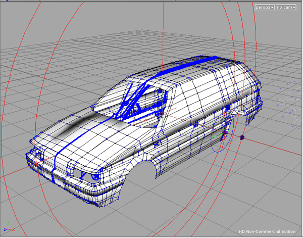

Unfortunatly I have to come back this early. This is where I am now:
As far I modelled from a short nonHoudini Tutorial. It says model this way, and when it comes to the doors, just cut them out. I liked that idea to avoid the polyknit problems mentioned above. And I thougt the knife tool could do the job. But now when I am here I found out that the knife tool can only cut one line. Thats not what I need. In Viewport right I would like to cut out the door with a shape (painted on the tablet) instead of a line.
Is this somehow possible?
If not I will go into subdivisions and remodel the door stuff. In this particular case its not neccessary to open the doors.
BTW: I am satisfied with modelling a car in houdini ;-) This is the very first car i do, and it looks similar to the original one. Done just from photos. And its much faster than I was afraid of. Great ;-)))

Thanks Greg!
I will try this out in my next model. Because I got stuck at this point, I worked the hole morning with some subdivision, dissolving and point moving things, and now the door shapes are in the original body model. I am just at the point to blast out the windows … and then have a little work left in the lower parts ;-)
