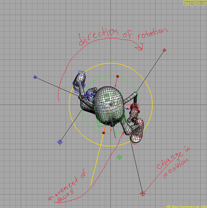

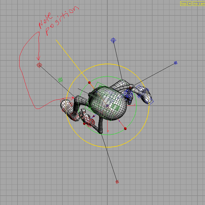

Here's some more detail on what I'm referring to, in case there's some confusion:
1st position:
After rotating clock wise:
Note that the right effector has maintained its position relative to the placer. The left one has move on it's own during the rotation. That can't be normal behavior. The result is that the left knee is altered and moves forward.
1st position:
