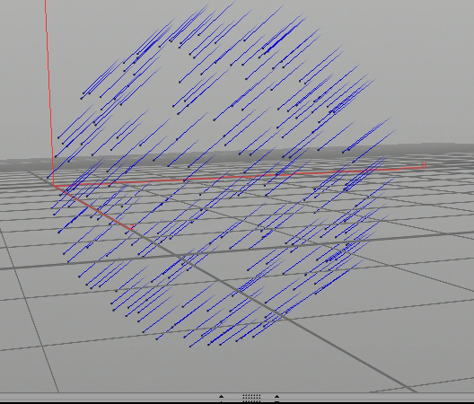

this is a simple poly sphere with normls points
the problem is when i scatter points on the sphere surface i want the new points to inherit the normals ,instead they all point to one direction
points sop or vertex sop or facet sop dosent fix the problem
20 posts
Joined: May 2012
this is the normals after scattering
2624 posts
Joined: Aug. 2006
works fine here

20 posts
Joined: May 2012
thank you man i move to the new version of houdini and it works fine
