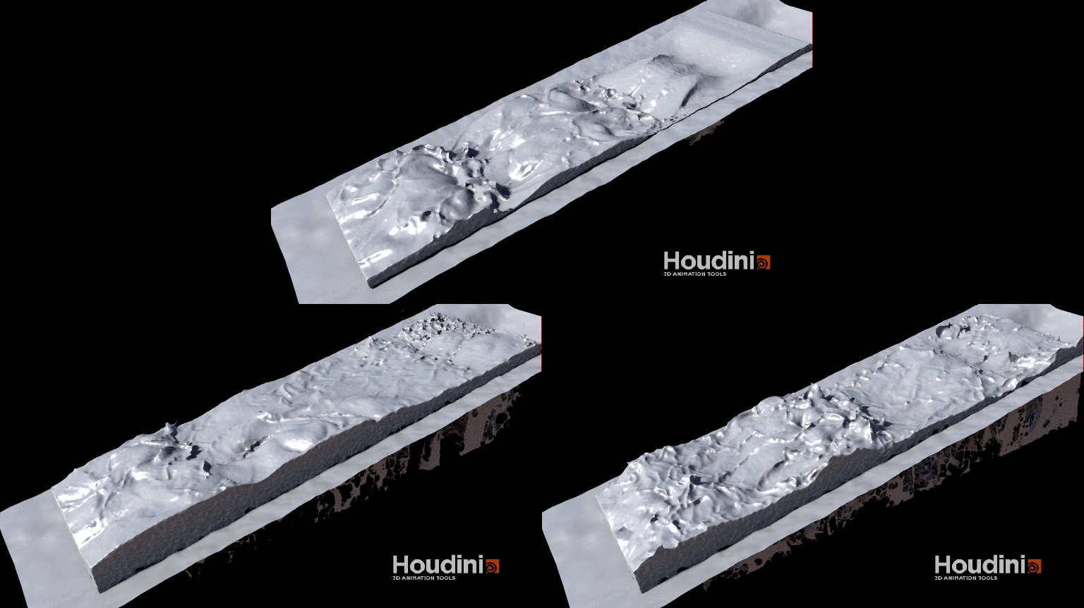

Gravity has accelerating effect on the sloped water to the point where it thins out and hits a terminal velocity which can be due to faster water colliding against slower water, friction against the collision surface, internal viscosity forces when the water essentially turns in to a violent mix of air and water and in extreme cases such as a waterfall, air resistance itself.
Flip doesn't have built-in checks to acceleration and velocity by default.
The fluid will thin out as the simulation progresses as your fluid accelerates just like in reality. If you clamp velocity you will get unrealistic motion for the fluid affected by the velocity as you described. It will look like muddy water with low acceleration/velocity thresholding to sludge with high acceleration/velocity thresholding.
Your reference image shows a nice calm flat river babbling over a small shelf in to a tiny pool and then slowly carrying forward and you want your fast moving water down a steep slope to have a similar feel. Two competing looks.
Ok.
The recommendations regarding bulking the sim by simply reducing the volume resolution wrt the particle scale size is fine but it will definitely change the look and not really counter the thinning of the fluid. In fact with more accurate velocities present at higher grid values may allow for even greater acceleration and velocities to be supported. Yes you can carry more particles but in the end it will thin out pretty fast and just delay the effect until further down the steep river.
I recommend you stay away from divergence as it requires a divergence field and a divergence pass in the flip solver. This will cause increased memory requirements and decreased sim speed for not much gain. FLIP can do decent water sims without divergence these days.
So here's the scenario: you need to add a terrific amount of fluid down a steep set of rapids which will create a simulation with an incredible amount of energy then send a raft down in to what will be an extraordinary set of class 6 rapids which no raft could navigate with occupants remaining in said vessel at the end of the ride.
http://www.youtube.com/watch?v=hFEQJ9ZuBfk [youtube.com]
Check out the 1:14 mark and that is pretty much the scenario in reality. Notice how thin the water gets and adding more fluid at the top will just create more of a frothy mess and not a nice thick fast moving sheet of water. The steeper the slope, the thinner the water gets given that the same amount of water is entering the falls at the top.
What to do to keep things real yet look exciting?
- Add flatish shelves with deep catch basins along the path of the river to try to create pools of slower water to impede the progress of the water moving over the thinner parts of the river bed. This is a plausible scenario if the river bed consists of very hard and very soft layers of rock that was eroded over time.
- Make your river bed less steep. Use a different camera location and lens focal length to make the river look steeper than what it really is.
So what cheats can you employ to give you some control back?
- Use Pumps to emit net new water in strategic places along the waterway with creative velocities mostly with the velocity in Y magnitude determinging fluid emission rate. Make sure the net new water has counter velocities to push back the water but not so much as to create too much turbulence.
- Add counter velocities in strategic locations along the river bed in the body of the fluid to keep the fluid in check without affecting the look. This can be done by adding/sculpting collision velocities to the river bed for example. Add velocities to the river bed in an upward direction of course but tilted back a bit in the direction of the water flow to kinda simulate a wee bit of drag between the river bottom and the fluid interacting in that localized region.
- Parent constrain pumps and sinks (with or without velocity sculpting) before and after the raft and in strategic parts of the river to get the raft to the height you want it to and to plow a path through the water churn so that it can at least look plausible.
Good luck!

From your pics, I notice that you are reducing the Particle Radius Scale when you are reducing Particle Sepration to get more volume. In my opinion you should not do that as you will loose particles.
Don't take my words, just put a flip tank in a new scene and playblast. And then without changing anything else, just reduce Particle Radius Scale to 0.5 from 1.2 (Default). Do you got what I mean to say. Now try doing same with 0.95. I am not saying don't touch this, experiment with it. In my tests, I have notice there is a value for this parameter, if you go below that you start lossing them.
Infact in one of my test, I was able to actually increase Particle Separation while retaining the details. I did few other changes in my setup to get almost same level of details and guess what I got some more voulme too. But those changes will not work for you as your reference/ target water is very calm.
Look what I said, a picture tells a lot then words. And see who came to rescue you.
Thanks Jeff for the great explaination and ideas to achieve the effects.

Glad to know, water flowing at ur end. Vidit you changed your reference, not a good practice on shot production
but I understand while working on something there might be new findings or change of course.
Particle separation for first part in movie for my early post, was 0.025 but for the later part it is 0.05. Huge saving on calculation and disk space. I used subsurface shader for the rendering water body with an env light using PBR. Please note that sim was not done using tank flow, I am still working on that method to get same kind of motion and detail. Although I managed to get permission to put test render on forum, but didn't got it for hip file. I am afraid at moment I can't share the same hip file.
But no worries, just to prove what I said in my early post and give you the exact method that changed my sim a lot with detail and volume, I am attaching another movie file. I used Jeff's scene to demonstrate the difference when you change particle radius scale and what happen when you tweak just one parameter on ur setup, check it out. Nothing fancy and if you have seen waterfall tutorial as well as Peter's video, they have explained the same, I just picked it.
but I understand while working on something there might be new findings or change of course.Particle separation for first part in movie for my early post, was 0.025 but for the later part it is 0.05. Huge saving on calculation and disk space. I used subsurface shader for the rendering water body with an env light using PBR. Please note that sim was not done using tank flow, I am still working on that method to get same kind of motion and detail. Although I managed to get permission to put test render on forum, but didn't got it for hip file. I am afraid at moment I can't share the same hip file.

Sorry for delay, was busy breaking things at work. I am able to tweak further Jeff's scene to get more details in sim. But let me first answer your questions.
1.At what scale should i sim with respect to world scale ….
It is a very difficult question to answer, people say do this, do that but my personal opinion, whatever works for you, gives you right scale in final render, sim at optimal level on your hardware and setup (very imp), gives you dynamics you are looking for. Actual world scale sounds good to work on but in reality we all know how hard it become to work on it, although not always but in some situation or case, specially if you are dealing with huge sets, like your case. I am not aware about your scene scale so it is not easy to give you a number.
2. Do u actually use reseeding,i notice it takes a lot of space
Reseeding is on by default and I have not touched it, so yes I am using it with default setting. I am not sure about disk space usage with it but it should not change drastically.
3. how do i get small detail that i can see in ur render.
No short cut or fix method as each scene will be setup differently and lot of factors will influence the sim. Need lot of testing, trying and failing.
4.can u also share some of ur stats.
Nothing great, sim for 240 frames took 2 hours that cost me approx 70 GB disk space and render took 26 hours with 12 GB RAM, OC i7 processor.
5.Will my base model on which am running the sim only can give more splashes flying
For sure your base model is going to help a lot, specially if you have turns and up-downs, like your reference images. Some time if I am not getting good response from floor then I add dummy geos in between for collision, same I am doing in Jeff's scene.
6.How do you really start your shot ? do's and don't
click on Houdini and jump in it
I am still learning and not sure the steps I am taking to get more details are right or not, but uploading some wip render samples from my tests. Not huge difference between these renders and I am still not satisfied with it, will work on it further. This week I faced some weird issues with my machine and while trying to fix it, I torn apart the files that I tweaked to get these renders. I will upload hip file in sometime, in case anyone want.
