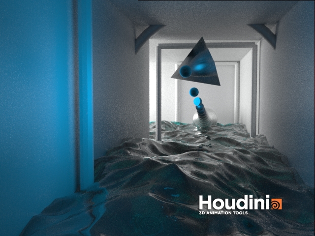

HI.
MAYBE you geometry, or i must say,maybe your bad geometry…
here a example pic and example scene.
1 min frame render. water, interior with refangle. area lights and of course, the best friend of interior scene a portal light.
for no flickering, turn off Gi light.
thanks.
interiorandwater.hipnc (3.2 MB)

hello helloui
perhaps interpenetrations i think.
you can convert you scene to vbd volume and reconvert it to poligons and baked the lighs, textures and so on.
or with comp. check the tutorials, the waterfall tuts have a very good tips.
