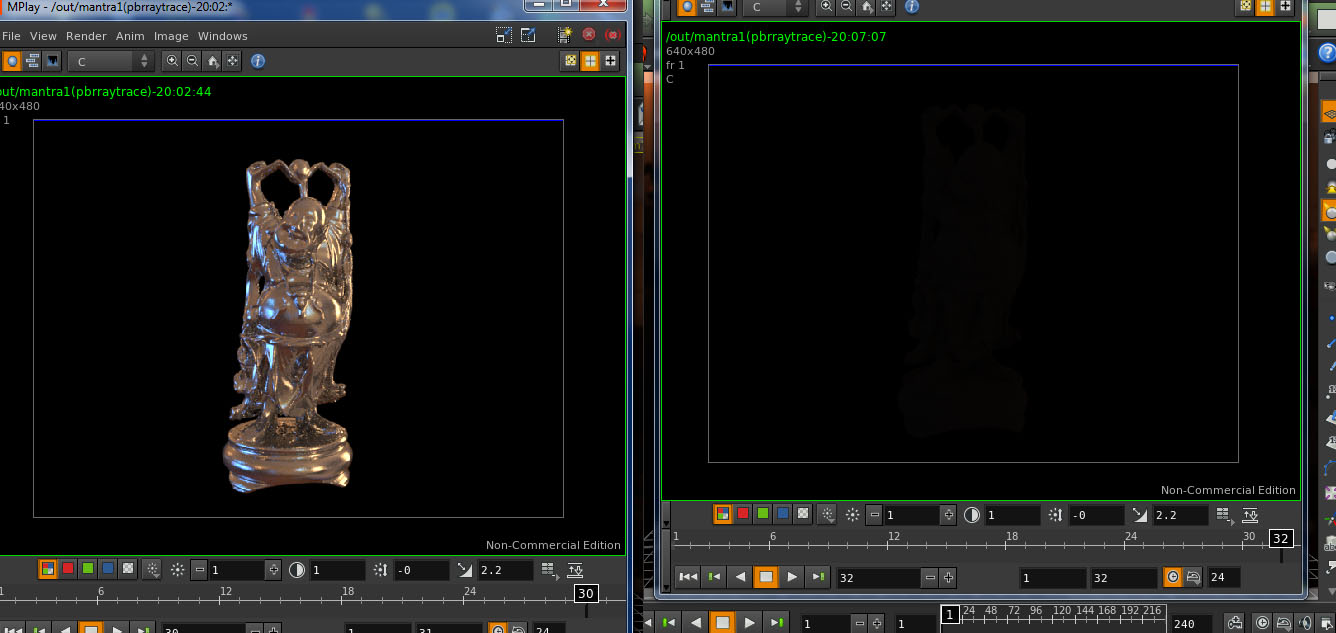

I installed that neat OTL lately, but it seems that I'm having the exact same problem with the specular as user ajz3d described! Does anyone know how to do the custom installation (because “Extra Files” tab does not contain the needed information..) ?

50 posts
Joined: July 2013
Thank you for your answer Sean. I'm aware about the specular being a light reflection The problem is… the reflections are also not there. Im attaching a file comparing the chrome presets of both material shader builder and PBR Layered material. As you can see, you barely see the second statue, because the reflectivity is missing, despite being set on I tried reinstalling the OTL, got the newest houdini build and the result is still the same..

22 posts
Joined: Aug. 2014
Then this is definitely an issue with the install. I just completed a commercial with a CG car and there was never any problem with reflections, reflecting the plate projected onto geometry, a skydome, lights, etc.
