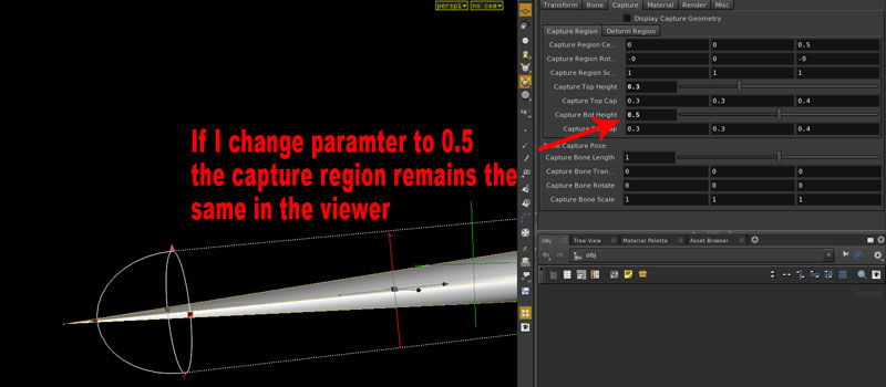

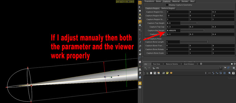

I'm trying to set the Capture Region parameters from the Bones > Capture tab but it is not working. The capture region remains the same.
See my attached examples:
Attachment 1) This is the initial stage with the Capture Bot Height set to 0.332441
Attachment 2) If I change the parameter to 0.5 note that the Capture Region in the viewer remains exactly the same as the default.
Attachment 3) If I change it via the handles in the viewport, then they both work correctly. The parameters reflects the changes in the viewport.
Is there something I'm doing wrong or is this another bones bug?

It seems to work for me when I modify the Deform Region tab parameters with Display Capture Geometry enabled.
You are right… to some extent.
I didn't check “Display Capture Geometry” because I'm not used to working with it. I prefer the see through controls if possible as I'm working with a lot of bones close together (mouth rig).
Having said this, I found that with the “Display Capture Geometry”, if you change the parameters, you have instant feedback in the viewport.
With the regular capture geometry wireframe type controls, you have to deselect the bone, then reselect it again to see the changes on the parameter reflected in the viewport.
Could be some bone display problems in the viewport as I was having another bone display issue as well ( https://www.sidefx.com/index.php?option=com_forum&Itemid=172&page=viewtopic&t=34523 [sidefx.com] )
Update: Definitely a Bone update issue in the viewport as I have bones disappearing now. If I modify their length or something else about them, they magically reappear :shock:
