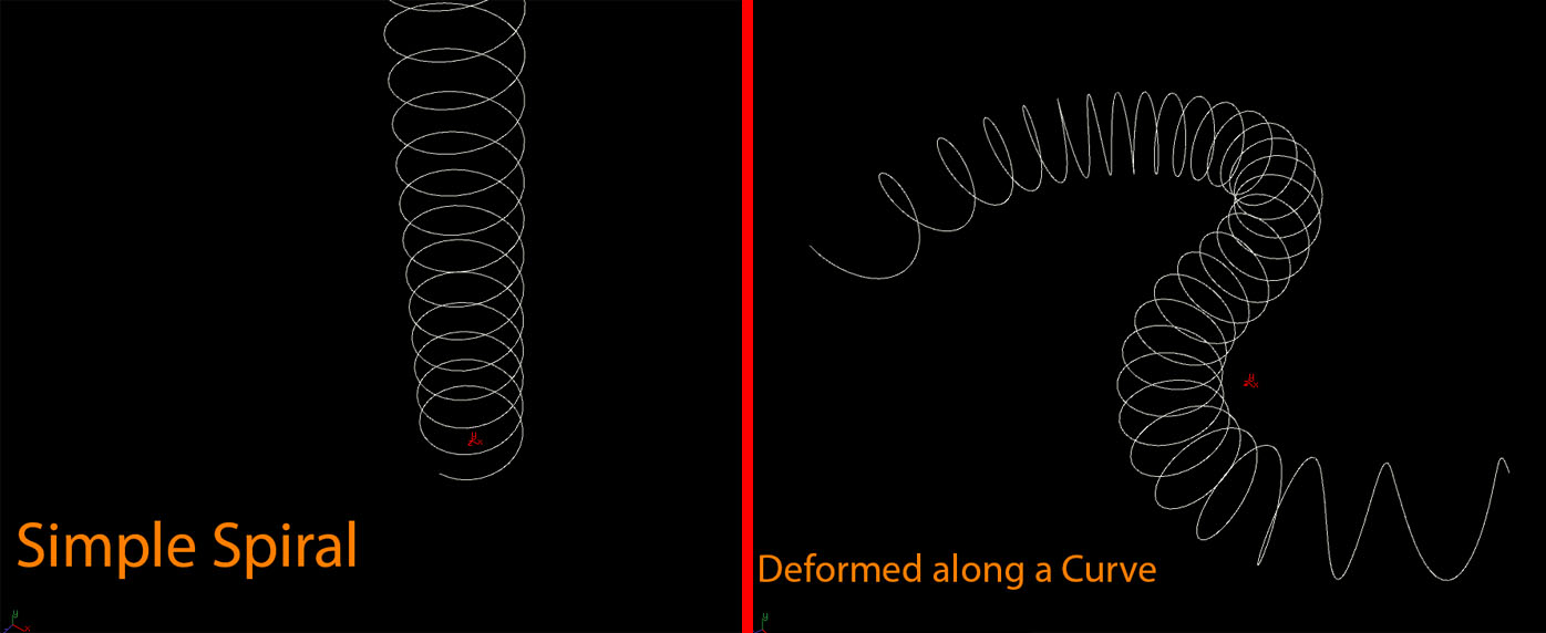

1391 posts
Joined: Dec. 2010
This is a simple example :arrow:
