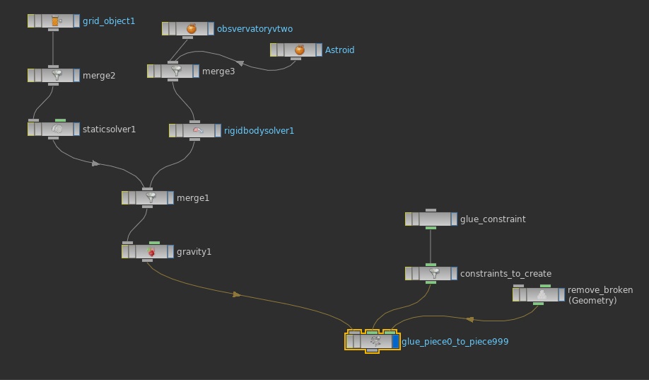

I'm trying to create an asteroid hitting a building. Both have been prefractured using voronoi then RBD. When i select the building to apply a glue constraint it seems to collapse on it self when both the asteroid and building RBD is in the DOPNET.
But when i just have the building in the DOPNET with a glue constraint the building holds up. I've tried smashing up the glue constraint up to 3000 and even tried giving the building and the asteroid its own bullet solver but it still collapse when their both in the DOPNET?
I've attached the HIP file as well as a JPEG of the DOPNET but if you choose to open the HIP file just be careful it's demanding on power. at least on my PC it was
