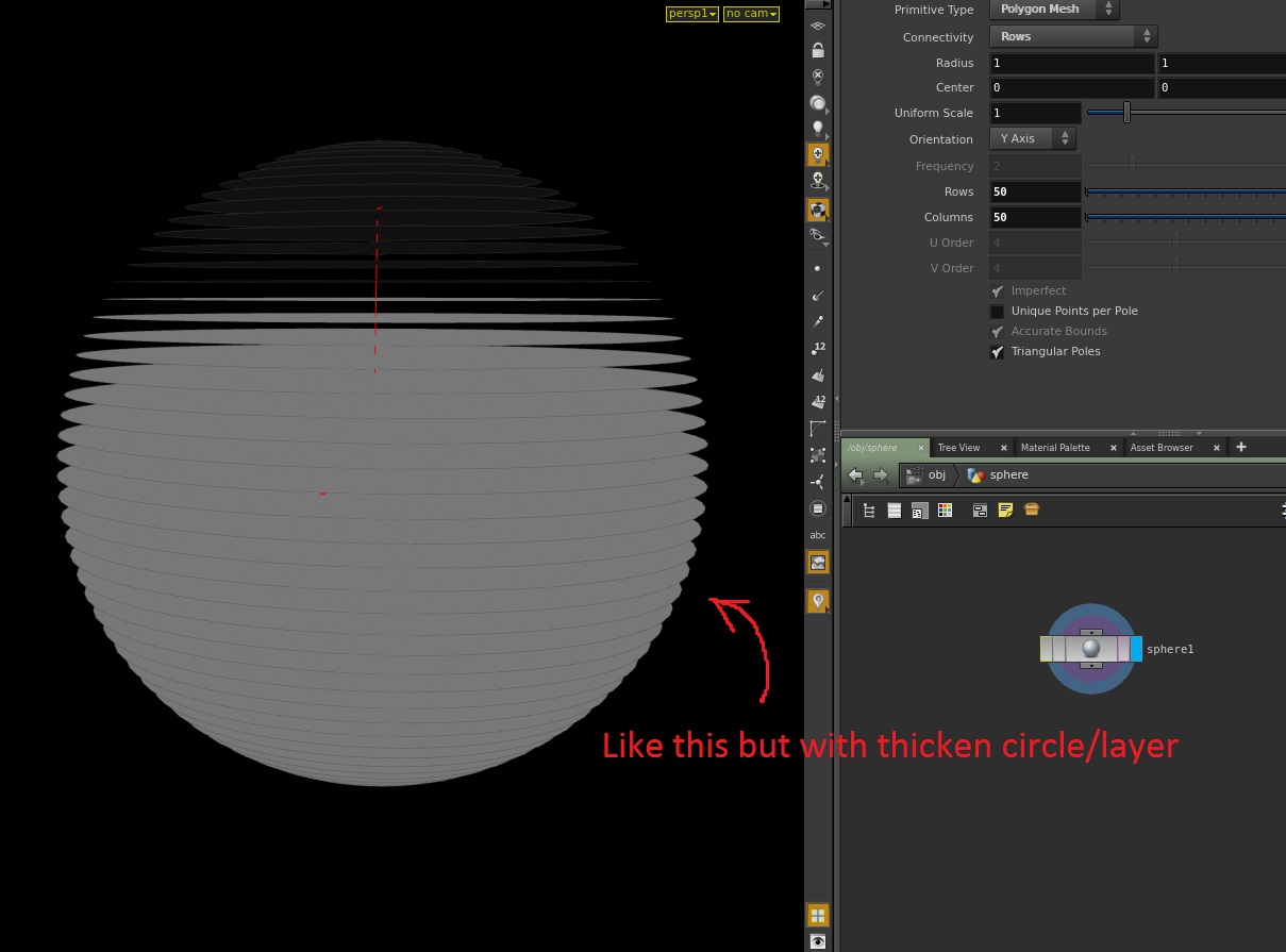

Hi guys,
I am trying to form a spherical shape using multiple thicken circle stacked on top of each other (in the form of copy sop, see image below). The thing is i cant make the side/edge of it more into curve or roundish shape.
The thing I am trying to achieve is something or similar concept like a sphere sop set in
Primitive Type: Polygon Mesh
Connectivity: Rows
Thanks
Connectivity: Rows
Thanks

If you want to do it with just math, you can use this formula:
sqrt ( 1 - pow ( t - 1, 2 ) )
where t could be:
$CY / ($NCY - 1)
for copied geometry without a template. If you are using a template, use $PT and $NPT instead.
where t could be:
$CY / ($NCY - 1)
