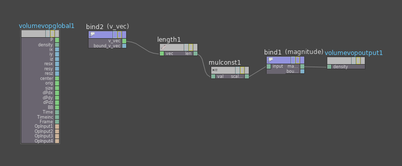

I found a post on odforce by eetu that hints at how to construct a vopsop to calculate the magnitude.
http://forums.odforce.net/topic/21784-flip-fluid-mantra-velocity-mesh-pass/page-2?hl=magnitude#entry129812 [forums.odforce.net]
I have modified the fluidtank fluid by placing a VDB Smooth SDF inline.
I have added a vopsop and calculated the magnitude.
I have typed the word magnitude into the alpha mask of the VDB Smooth SDF.
But it still does not work. Houdini tells me I don't have a mask when I just calculated it.
Does anyone know how to make this technique of scaling by velocity work?

Hi, a couple of things need fixing.
The velocity volumes coming out of dops are usually named vel, not v. The point attribute tends to be v. You can always check this with MMB over the nodes.
To modify volume data, you need to use a Volume VOP.
If you want to write to a new volume, in this case speed, you need to create the volume before the Volume VOP. (The default volumes coming out of a flip sim are surface and vel, in this case you could just overwrite the surface data and bypass the need to create a new volume)
VDB smooth SDF probably wants a VDB volume in the mask, so you probably should convert your volume to VDB with Convert VDB SOP. I don't know how the vdb smooth sdf sop decides which volume to use if there are multiple volumes coming in to the second connector, maybe it takes the first one, so to be on the safe side you should probably delete the unnecessary volumes before that.

It ends up you don't need the VEX code at all. The VDB From Standard Particles node uses pscale by default.
I have working HIP solution to this lumpy problem posted on od|force. [forums.odforce.net]
