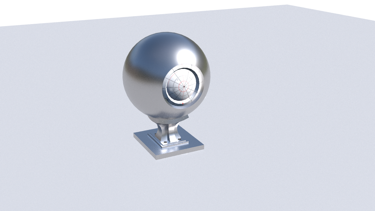

If you want a object not to be visible in another objects reflection or to cast a shadow onto the reflective object ? > if so just set to primary in the objects visibility tab .
example 1 .uses primary ,
example 2 uses the reflection mask on the object and the shadow mask on the spot light , this way the object shows up in the balls reflection and casts a shadow on it but not the grid.
