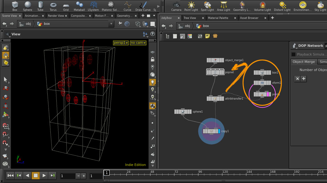

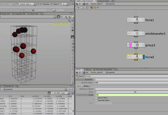

He has shown a way how colors from box can be transferred to particles from SOP box and then forces be applied on the particles based on their color. plz check snapshots 01 and 02.
However in H14, new popnet doesn't allow attributeTransfer node. So the question is how to bring attributes from sop to the new popnet… Anyone plz show how to. I am attaching houdini file so Masters of Houdini can quickly sort out this mess.

yes sopsolver is doing the trick.
First the whole node tree was confusing. I was unable to understand how three paths were leading into the same “wire_pops_into_here” thing. Also how the sop solver was acting simultaneously… had to watch some tutorials on new particle system to understand what you achieved.
