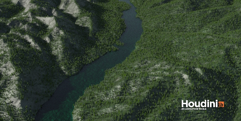

I find it to be a good practice to work on limited machines to train myself for optimisation reasons, I managed to make a quiet nice render with almost 200K boxes as proxies for trees on a landscape. With file instancing and delayed loads, I believe I can push it even further, , if I can fix the licensing issue

Here is what's coming close to the limits of my ram
Proxies are just boxes in a copy node, so no delayed loads yet, I'm curious if I the system can render the actual low resolution trees if I used file instancing.
