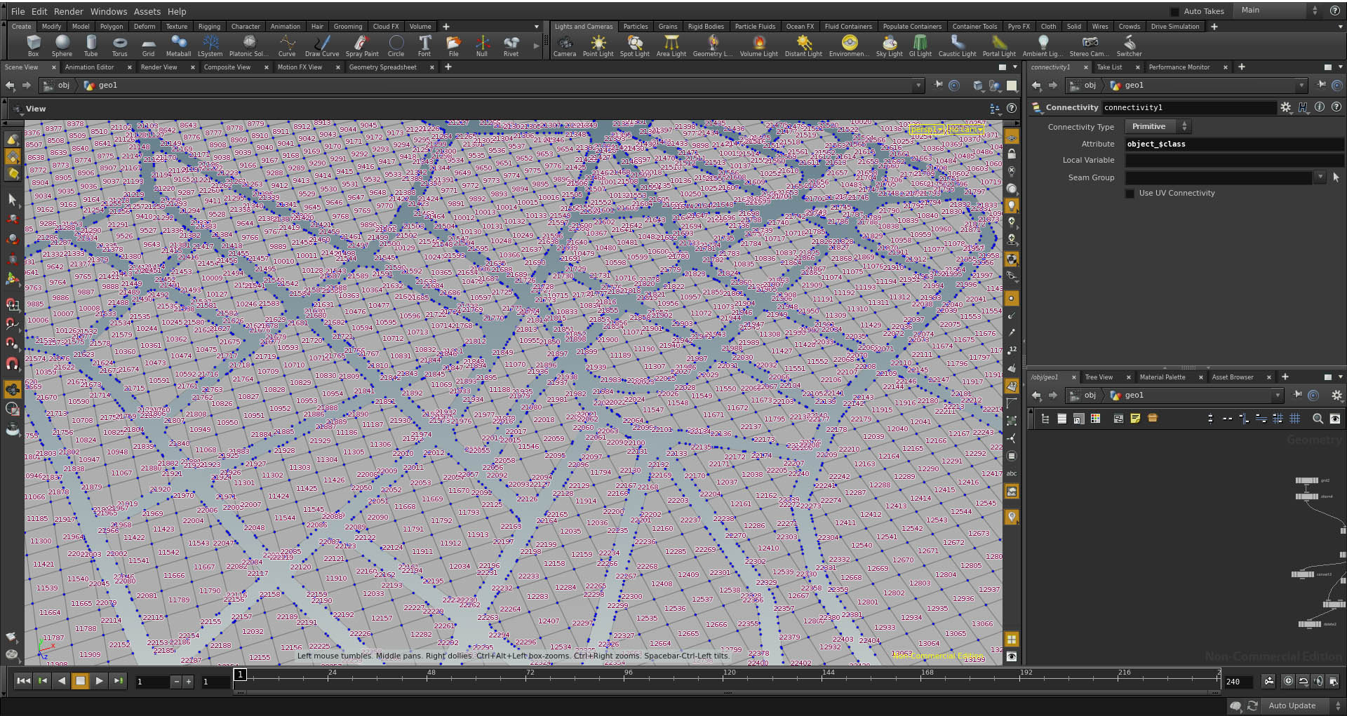

I'm wondering if anyone knows of a solution to this problem:
I've attached an image. I have a large mesh which contains lots of mesh shells. Currently each face is a primitive. I'd like to be able make it so each mesh shell is a single primitive. So I can then perform actions on each shell individually via foreach or clonestamp. Is this possible?
Thank you! .
3466 posts
try the connectivity and partition SOPs
you can put each ‘shell’ in a group and then use that to preform your operations in a foreach etc

Hey Arctor,
Thats awesome thank you. It worked perfectly.
