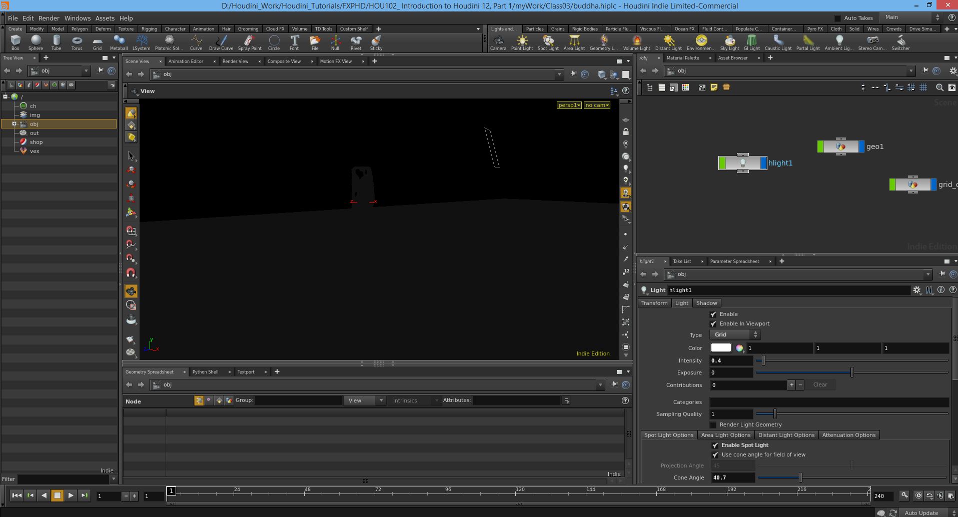

I am having this issue (image provided) where my lights barely show up or not at all in the viewport and do not know why, any thoughts? I am using Houdini 2015 Indie Edition with high detailed lighting on.

try increasing the exposure value on the light.

I have, no changes happen… it just stays like that when I change the light to a grid (area light).

-maybe if you could try posting a hipfile.
from that image, I also notice that your area light has Spot Light Enabled. Is it possible your light is aiming in the opposite direction?
