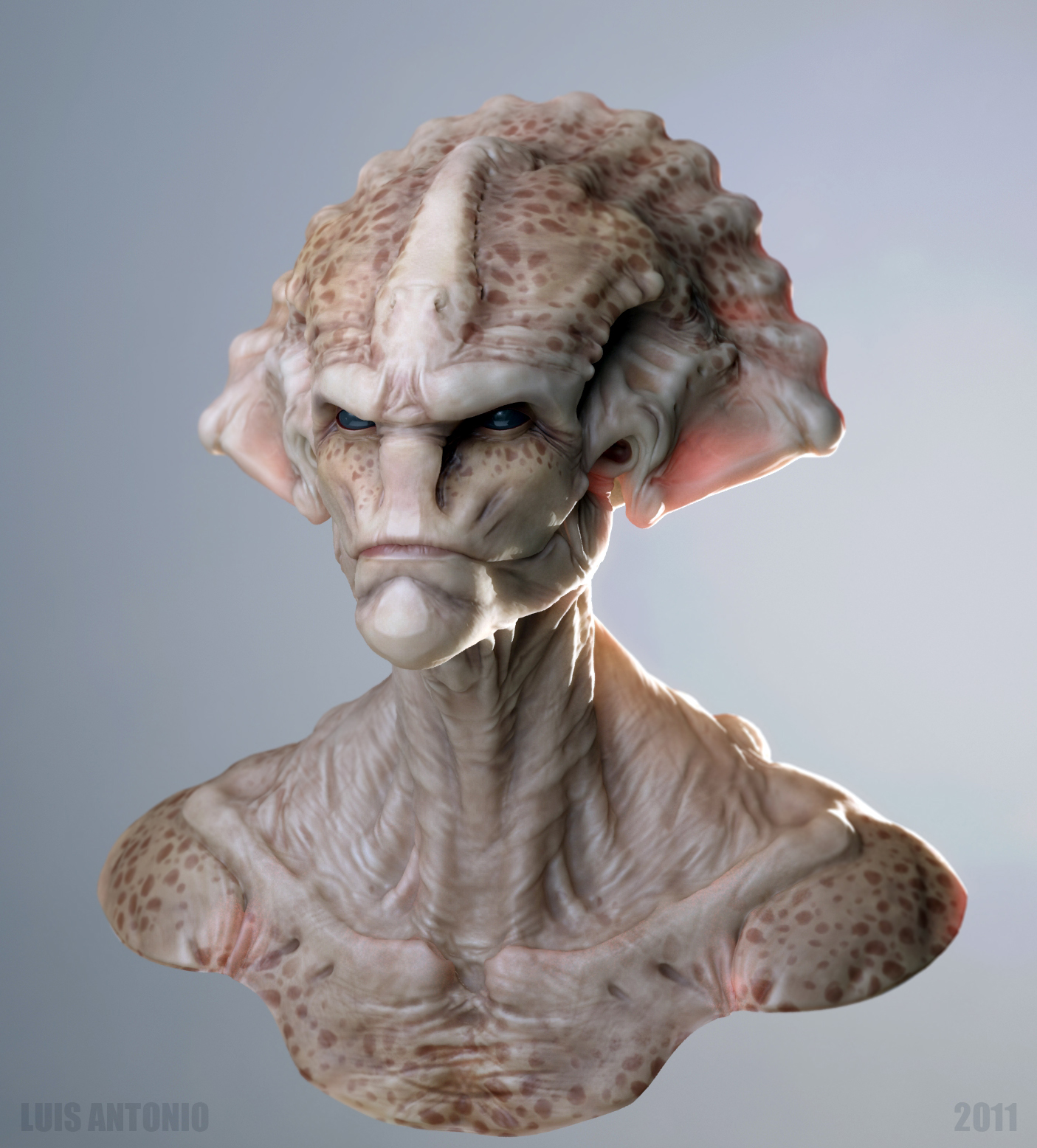

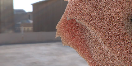

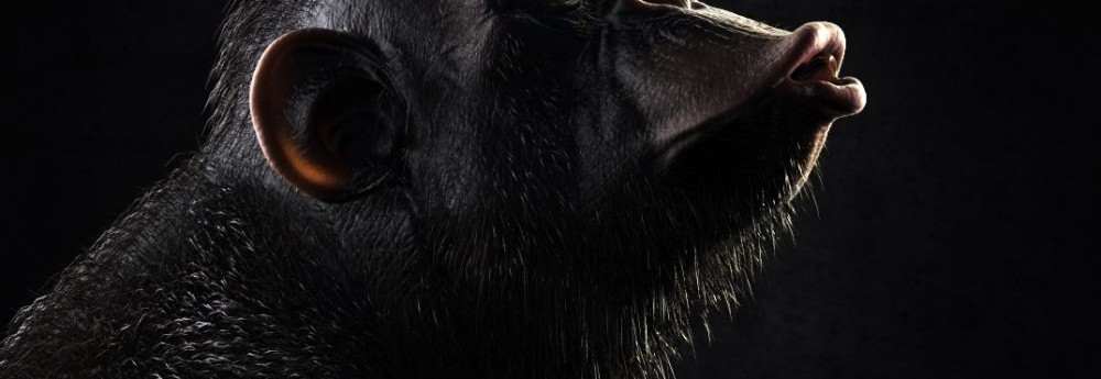

Examples of what I want to achieve followed by my best attempt so far in Mental Ray with the fast skin shader.
