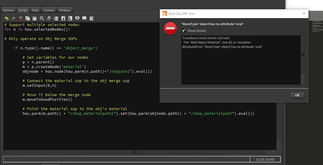

I'm trying to do exactly what you have here, however, i'm getting python errors when I try to execute the script. Do you have any idea what I'm doing wrong? I really appreciate any guidance!
(I seem to be having trouble uploading, so here's Drive links to the images just in case):
The Code:
https://drive.google.com/file/d/1Dr3cjunpq_rNvPVNKskRaM2VYr4t8rJD/view?usp=sharing [drive.google.com]
The Error:
https://drive.google.com/file/d/1lagdSwj5bILW8eY_raYzQ9HYt8ydjvBp/view?usp=sharing [drive.google.com]
Thanks,
Weston
- neil_math_comp
- 1743 posts
- Joined: March 2012
Hi Weston! It looks like you have an extra right-double-quote character after the
/shop_materialpath1text inside the string.

Oh, if
objnodeisn't a Geometry object, there won't be a shop_materialpathparameter. I guess the script will only work if the Object Merge SOPs are merging from objects, instead of directly from SOPs. You could probably check if objnode is type geo, and if not, switch to using its parent. Putting omething like the following code before the evaluation line might work, (though I'm not great with Python, so I'm just guessing) :if objnode.type().name() != 'geo': objnode = objnode.parent()
- weston.slater
- 4 posts
- Joined: July 2016
That worked! Thanks a bunch, I really appreciate it!! Here's the code for anybody else curious:
