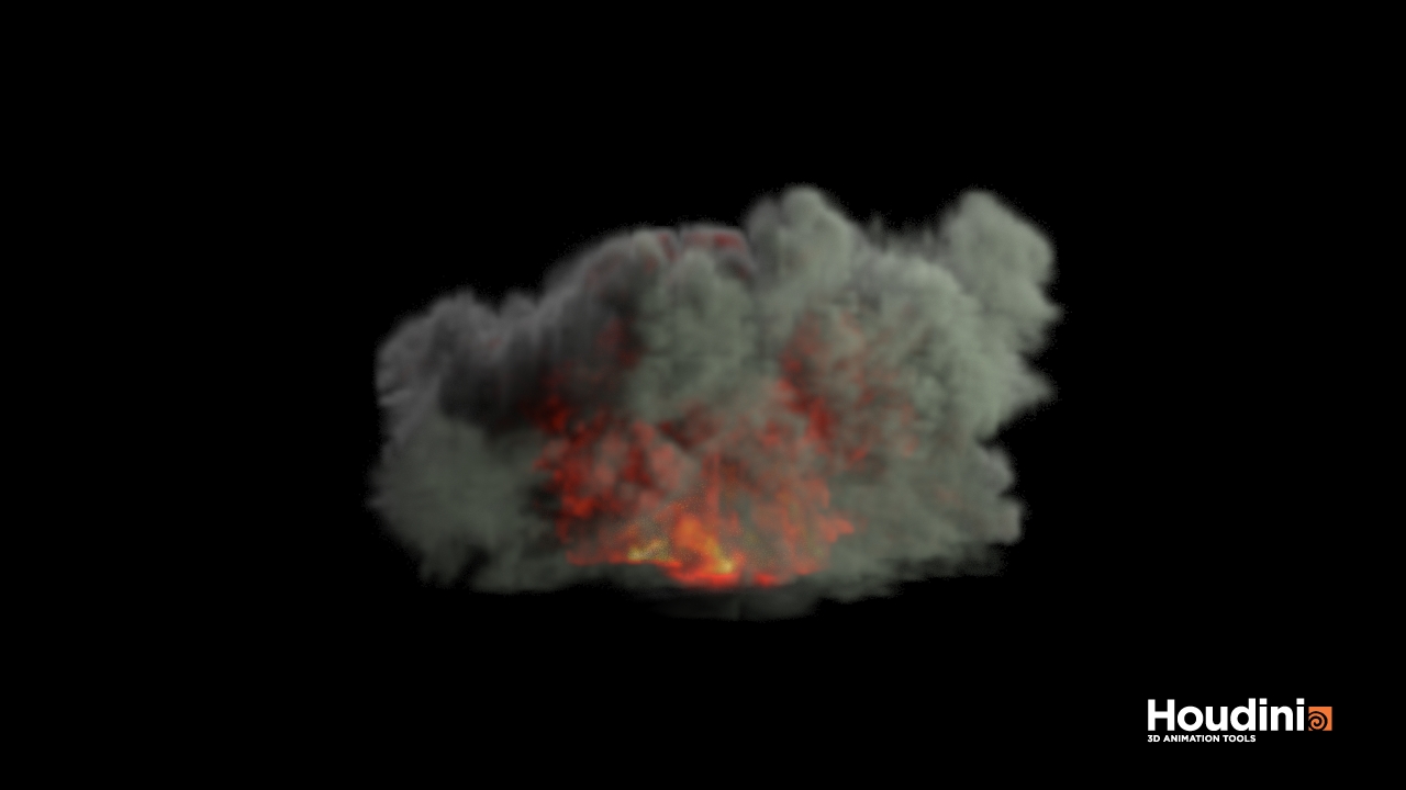

Here is a render of your scene with following changes
1. Volume filter from gaussian 0.1 to gaussian 1
2. mantra pixel samples from 24*24 to 4*4
3. I also killed your pointlight1. Nothing will ever look good strongly frontlit.
This doesn´t look as the awsome stuff you see on internet, but hopefullt it will get you started.
The resolution baldwithglasses refers to is the division size. Lower this parameter to get more voxel = more detail = longer simulation times.
From the help about volume filter…
Some volume primitives (Geometry Volumes, Image3D) can use a filter during evaluation of volume channels. This specifies the filter. The default box filter is fast to evaluate and produces sharp renders for most smooth fluid simulations. If your voxel data contains aliasing (stairstepping along edges), you may need to use a larger filter width or smoother filter to produce acceptable results. For aliased volume data, gauss is a good filter with a filter width of 1.5.

Wow this really took care of the resolution problem. Sorry I forgot the pixel samples 24*24 while trying things… I thought volume filter must be very very very low like pixel samples but as you showed it is not.
