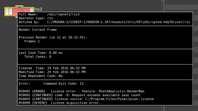

I have downloaded and installed 20.7 and the error is gone, yet now there is a new license error.
I looked at the license and it looks like it is indeed a non-commercial license.
1473 posts
It looks like somehow a few RenderMan processes (renderers) try to run at the same time. Perhaps Render View tries to restart while one is running.
Try rendering just a single frame from the ROP node and see if it works. Otherwise, maybe you need to re-run RMan's license manager to update the renderman license for the new version?
