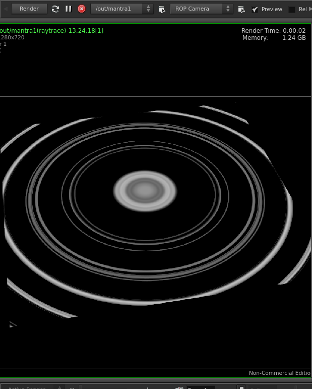

and this is currently my shop setup and what it looks like when I render. The new_gradient Node is a small asset with a radial color gradiant.

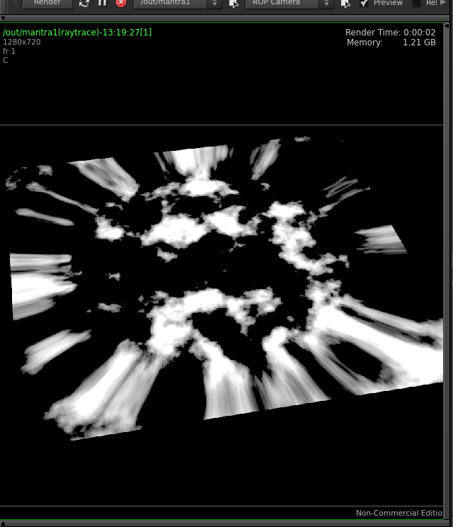

and tried to adjust it to my purposes but it just didn't give me the results I was looking for. It distorts the UVs Scale but it just looks messy.
You can see the best I could get out of this setup, below.
If I just connect the ramp to the pos of the noise it distorts the noise in a radial kind of way not towards the center like in your examples.
It looks like the Screenshot at the very bottom
