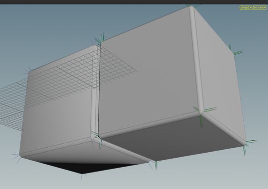

Hi. I'm a newbie and I'm looking for a way to do face weighted normals in Houdini for game assets. (http://wiki.polycount.com/wiki/Face_weighted_normals) [wiki.polycount.com]
The left box is a box made in Houdini with a polybevel and nothing else. The right box is a box made in Blender, beveled, then the normals were edited with a face weighted normal script.

That method gives me hard edges which I don't really want, but it could be useful for some other things I guess. What I'm really looking for are smooth edges that kind of look like a high poly (subdivision) mesh when it's really just a simple mesh.
Here's another example that maybe makes more sense. The left mesh is the face weighted normal mesh and the mesh to the right uses a normal node with cusp angle 30. The geometry is the same.
If there's no such thing built in I guess I could write a script for it instead.
I don't think any built-in node provides the behaviour you described but a custom tool could be built using the Attribute Wrangle SOP. Attached is an example implementation.

That looks great, thanks! Now I just need to find out what makes that work… :shock:
Wrangle nodes let you run a snippet of VEX code on your data. The Attribute Wrangle SOP in this example runs over points so the code is evaluated for each point. Also, the “v@N” means a vector attribute called “N” on our data (in this case points). Here is an easier to read version of the code:
