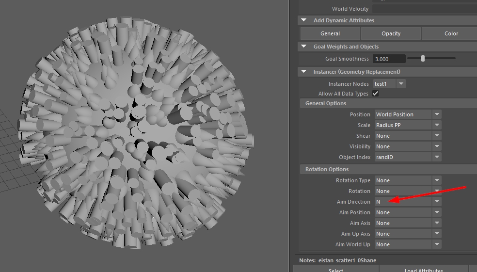

Im trying to make some nice scatter for me with houdini scatter and I have some questions. And first of all maybe somebody did it before, im interested in how did u do this?
I got just point scatter from houdini with several parameters, and trying to scatter objects on it, but I cant turn of Normal direction with random Rotation in the same time, cuz rotation rewrite all normals.
And as I understand there is diffrent way, doing it with instance from houdini, but how?
