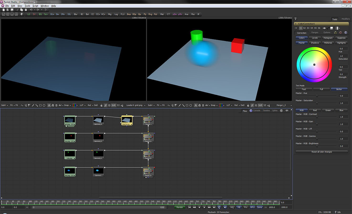

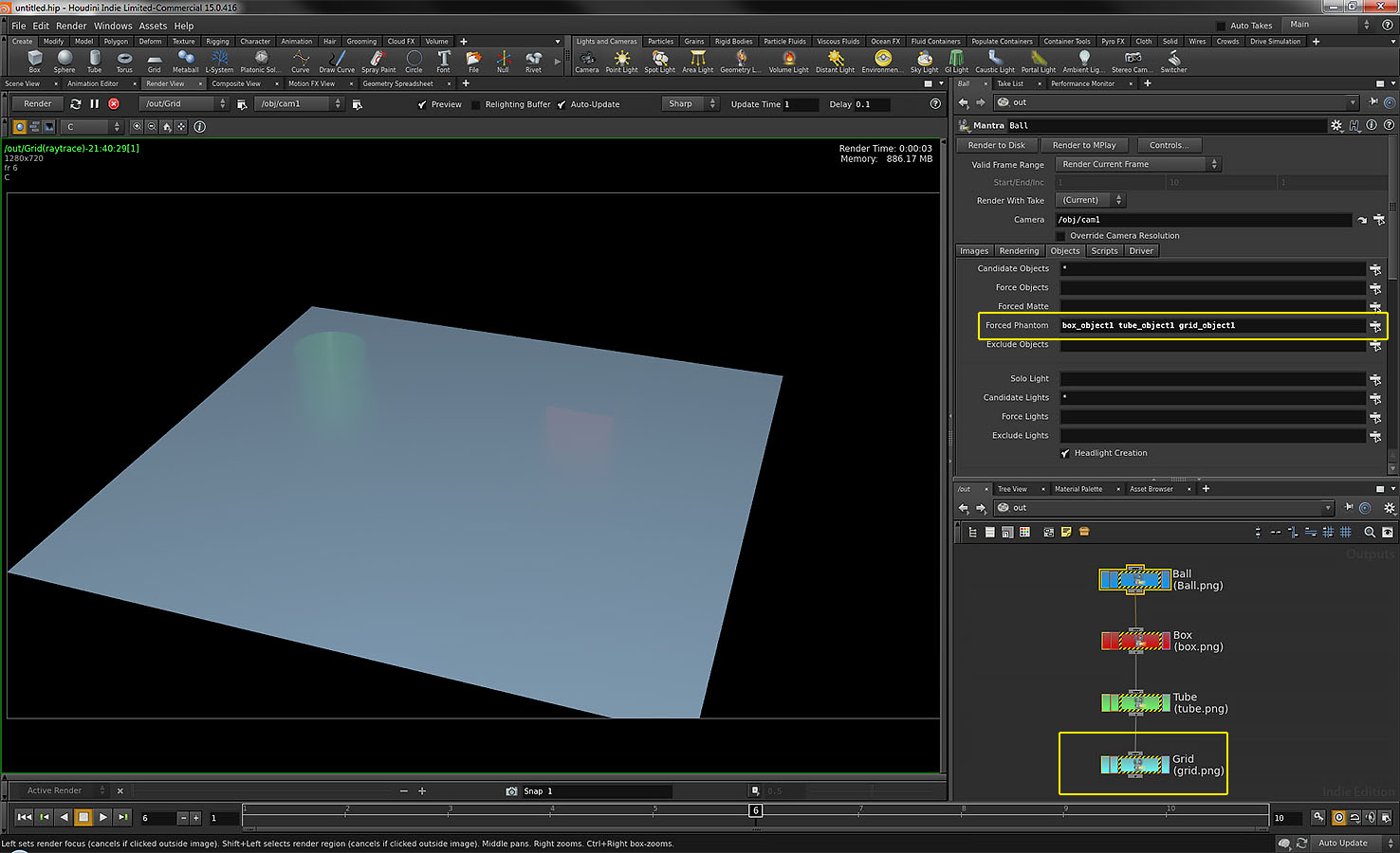

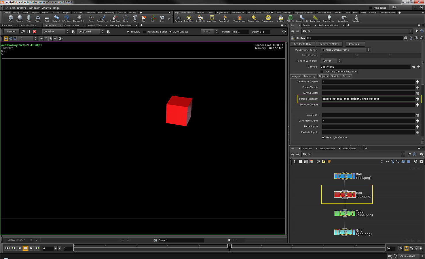

1.The pixel filter was the problem. I set the pixel filter to minmax idcover, as described in an old tutorial. Keeping it blank, generated an object id with motion blur. But unfortunately I have some problem on the composition side.
2.The basic is not difficult at all. I don’t have to use Task at all, but you can go that route it you want to. Please see my examples. I can render separate pieces, but the GI light is left out, so the objects are much darker. Maybe this is due to some photon problem since only one object is visible in each render.
I’m coming from Lightwave, and in Lightwave there is an option to tick off an object as unseen by Camera. There is no interruption to the scene at all, the selected object will just not show up in the rendered image. It is still reflected in other objects. I thought Force Phantom worked in a similar way.
(Not sure how to add text to each image)
Below you can see a Houdini scene were all objects are rendered.
Then a setup were all objects are rendered using one Mantra node for each object.
Then a setup in Fusion.
And a color corrected plane (Yellow) in Fusion.
The two last images shows a setup using Object ID.
Houdini render the ball in many passes in order to generate motion blur. All those passes has it's own ID in Fusion.
That is a Fusion problem and I will check this out in the Fusion forum.
Hope you understand what I am trying to achieve.
Thank you again
Reco
