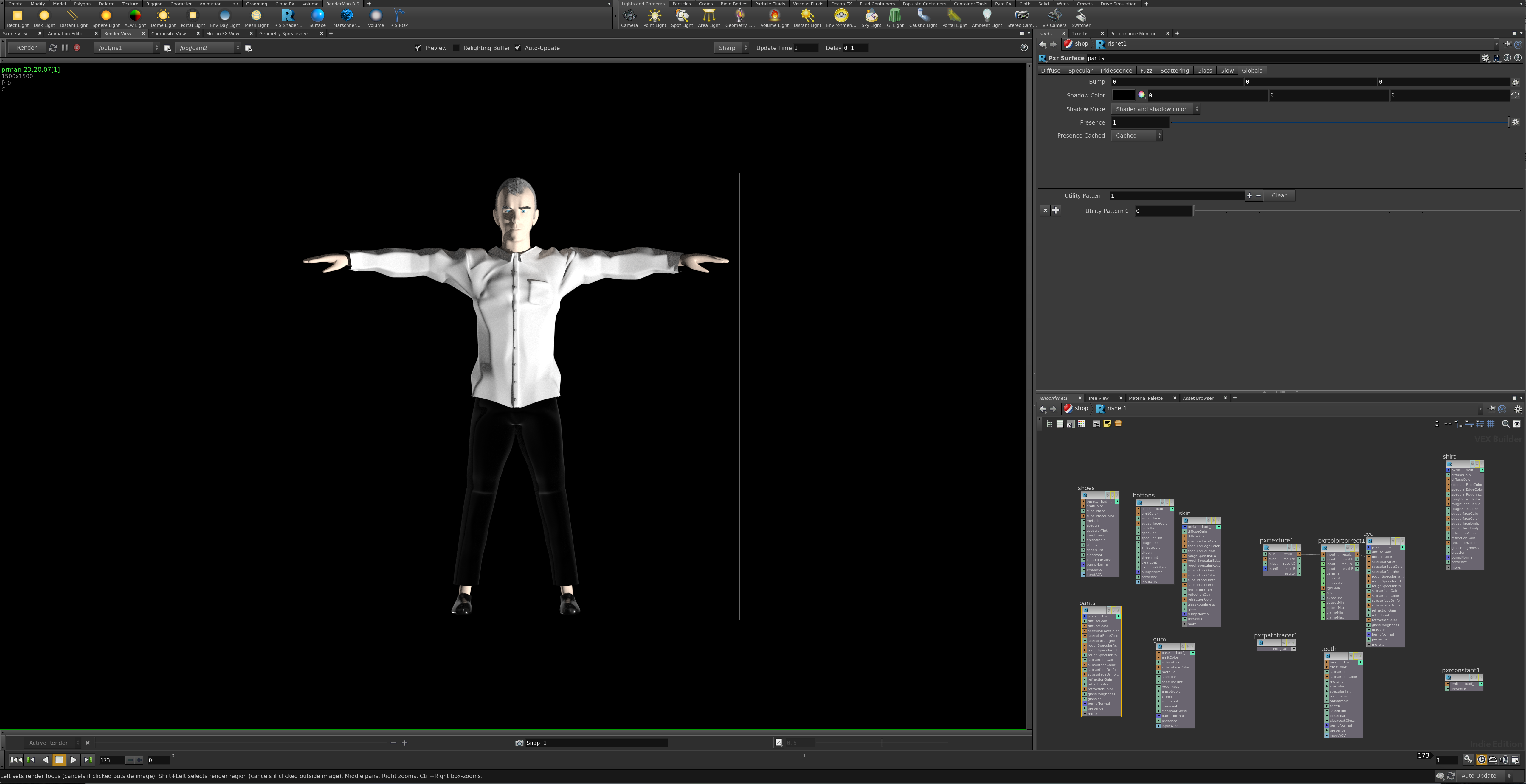

Hello It is my first time rigging properly and I finally managed to rig the whole body.
Now I want to add clothes and hair to the body which I have already made.
I tried the hair simulatin and cloth simulation but both seems to take too much memory and time to simulate..
Does anyone know any cpu friendly way to attach clothes and hair to the body? The hair doesn't really have to move at all since it is short hair and I want the clothes to move together with the body but the they don't really have to act like proper cloth since it is just a shirt and pants..
The whole thing looks like the picture below. Thanks!

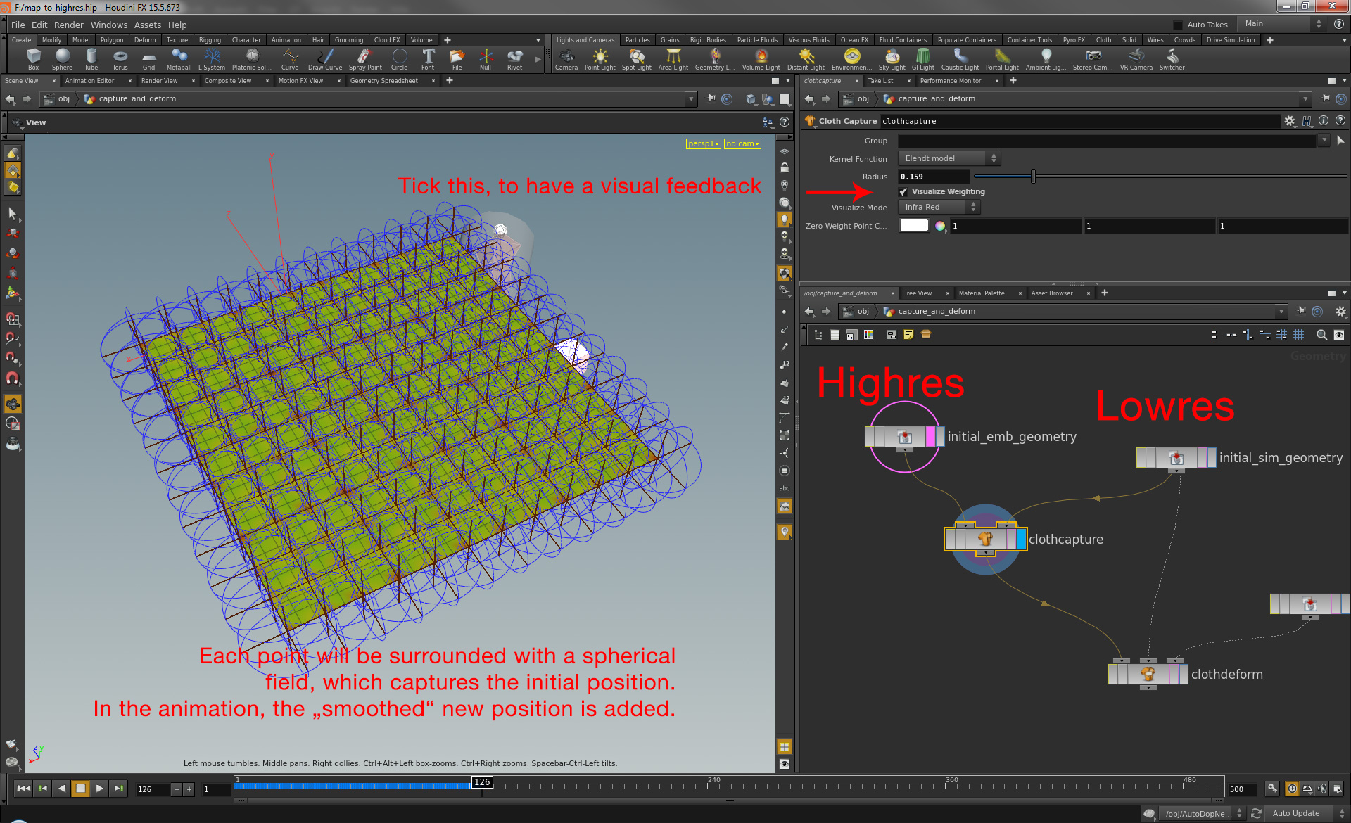

The base idea is to have proxies for both,
the body and the cloth. Then the highres version
of the cloth is assigned to the lowres version.
Hope the picture is helpy.

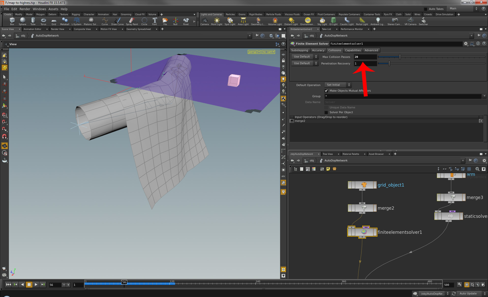

I managed to simulate cloth by using polyreduce for the body and clothes but still too slow and now the body is showing through the clothes! Can someone help please!

In this video i tried to show what the capture is doing:
If a point of the highres geometry is inside a given search radius,
it will get the deformation of the lowres version.
Increase the Collision passes.

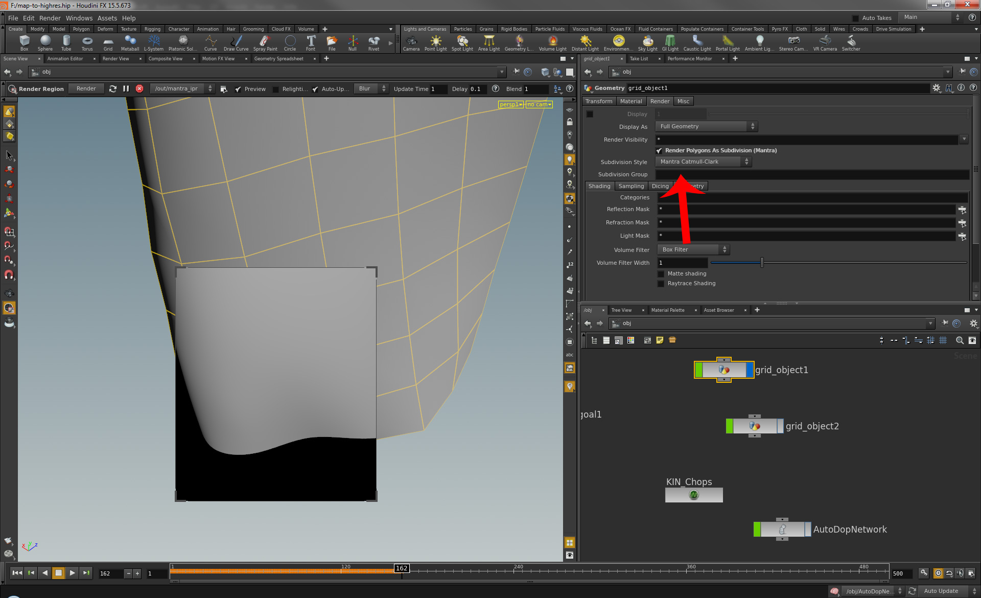

In my opinion your final mesh is to dense, too.
Better use “Render Polygons as Subdivision”.
Or use a “Subdivide Sop” after deformation.
