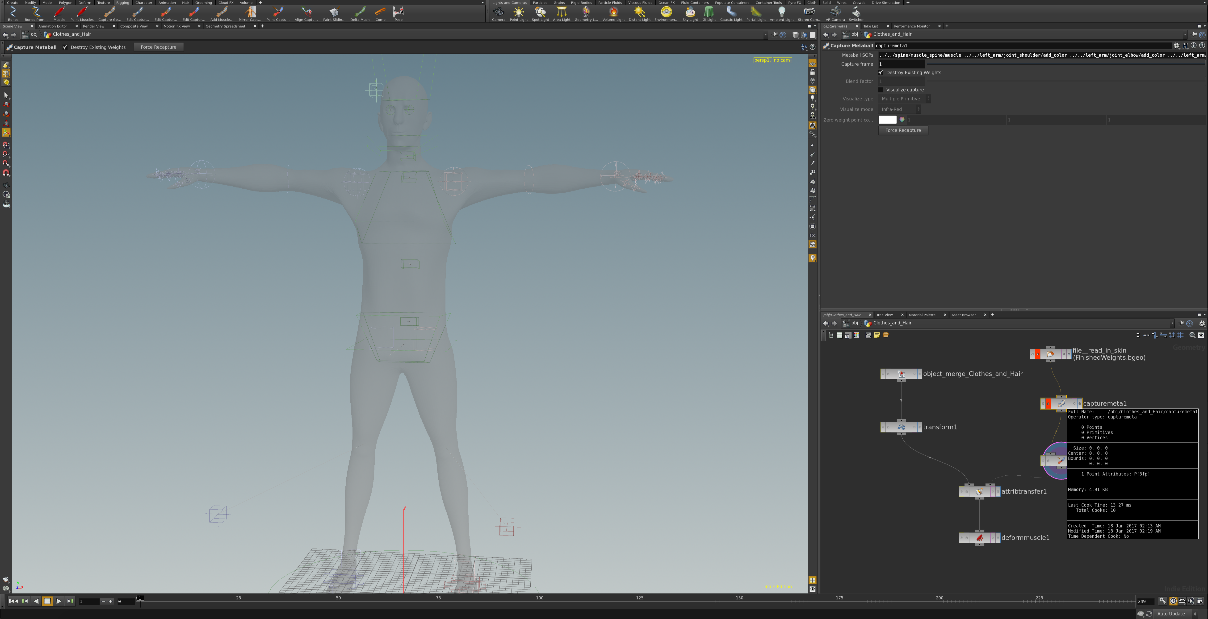

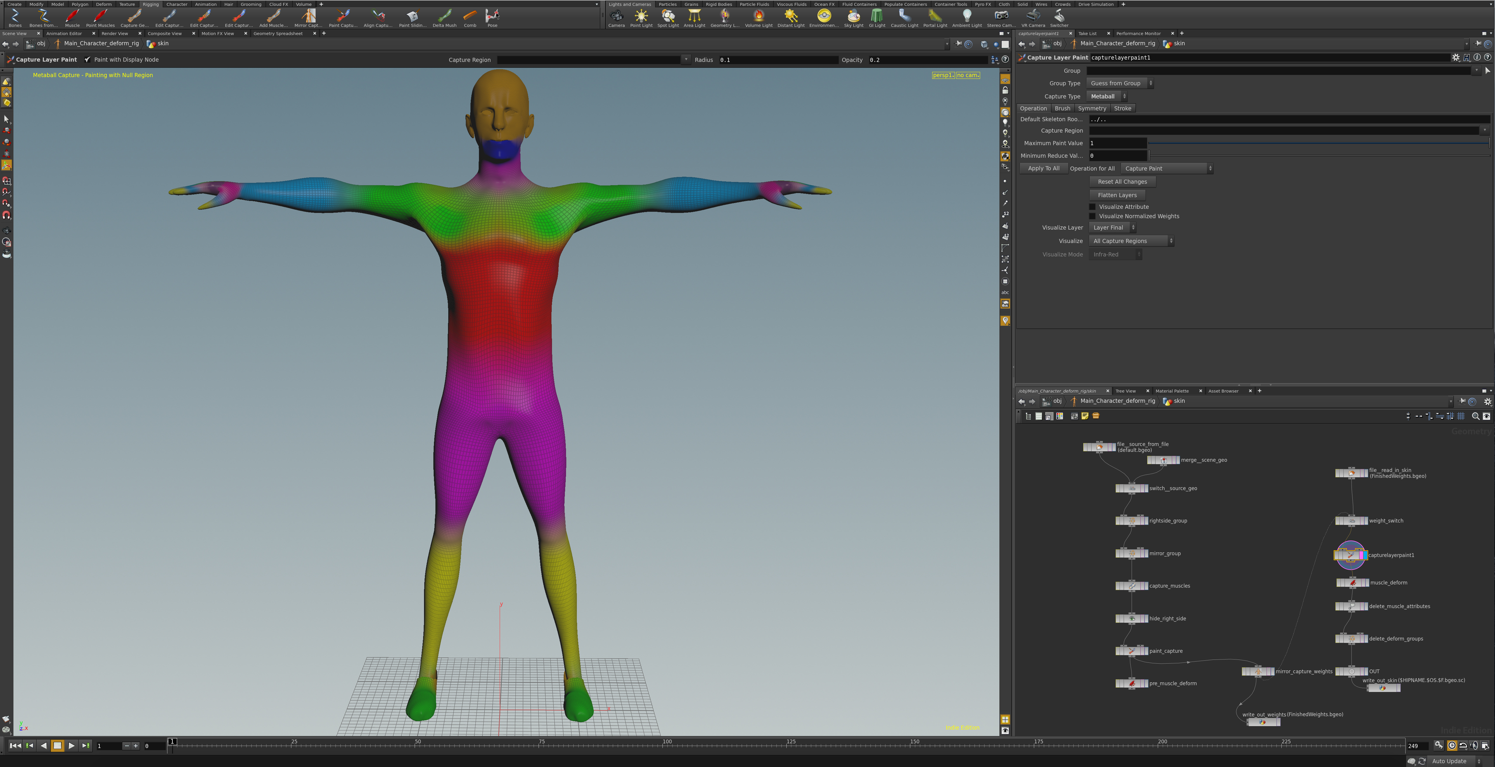

Okay 2 questions.
What node am I supposed to transfer? A capture layer paint node or a capture metaball node?(I am trying to put the node after the weight switch shown in the picture)
And what kind of deform node should I use for the clothes? Deform, Deform Metaball or Deform Muscle?
スクリーンショット 2017-01-17 23.25.43.png (203.7 KB)
154 posts
Joined: March 2016
Okay by everyones help I finally got to this point. I copied the weight file directly and recaptured it and then locked the capture meta node.
Now all I have got to do is input the “metaCaptGroups” into the attribute transfer node.
Does anyone have any suggestions of how to do it?
Thank you very much everyone for a long time by the way
スクリーンショット 2017-01-18 1.15.17_00000.png (2.0 MB)
154 posts
Joined: March 2016
Sorry and one more error. When I attach a capture layer paint node it seems like the weight is not properly transferred.
Can I get any help for this as well please?
154 posts
Joined: March 2016
Okay and Capture meta has no points, primitives or vertices so I am guessing that I have to put in the right input in the Metaball SOPs?
Because it does have the right amount of points, primitives and vertices in the file read in skin.

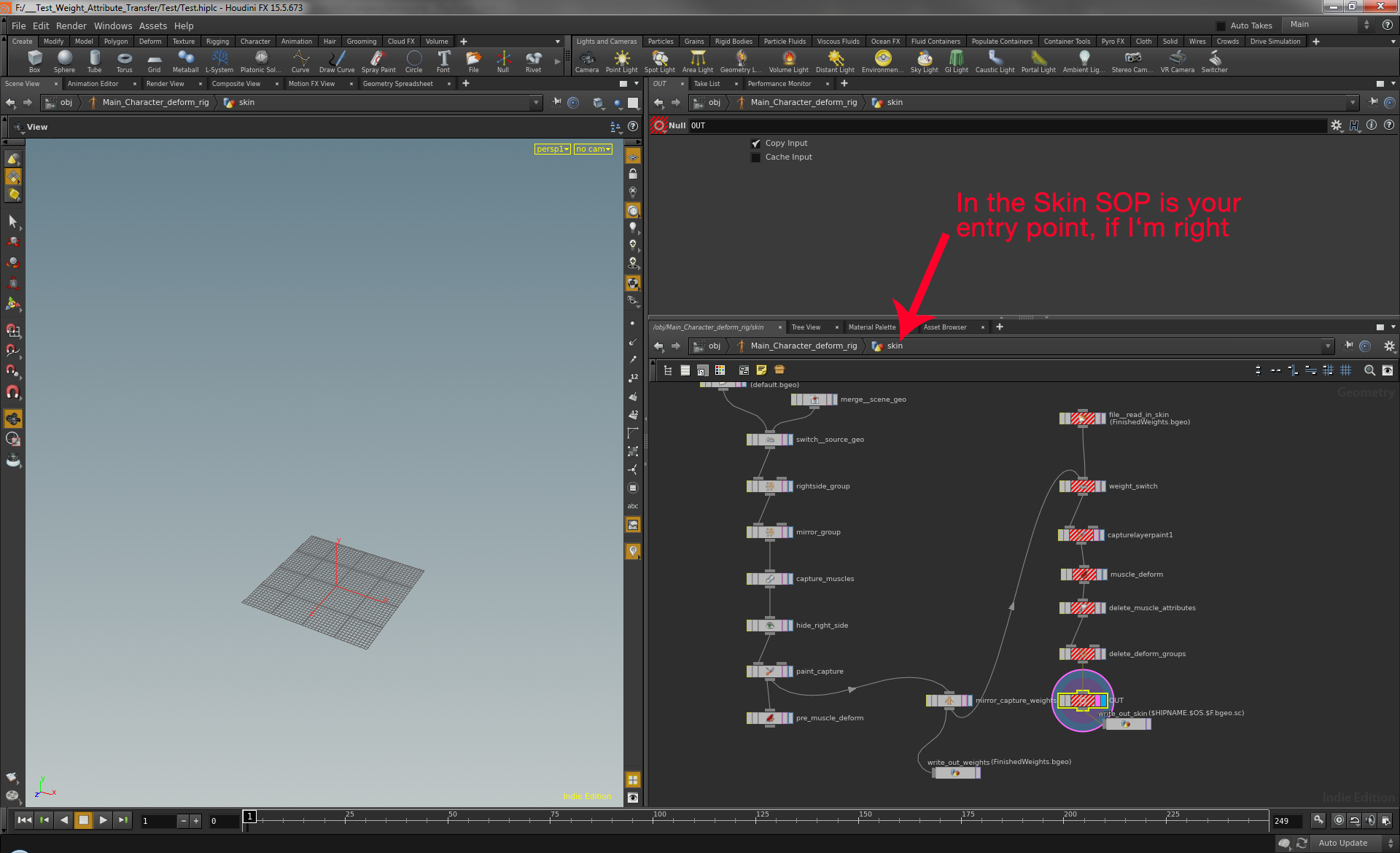

483 posts
Joined: Dec. 2006
Hi malbrecht, many thanks :-)
@Almina, I can have a closer look today in the evening,
but first look says:
/obj/Main_Character_deform_rig/skin/file__read_in_skin
is missing…. and: is this a v13 Biped AutoRig?
The Main_Chracter.otl or where does it com from?

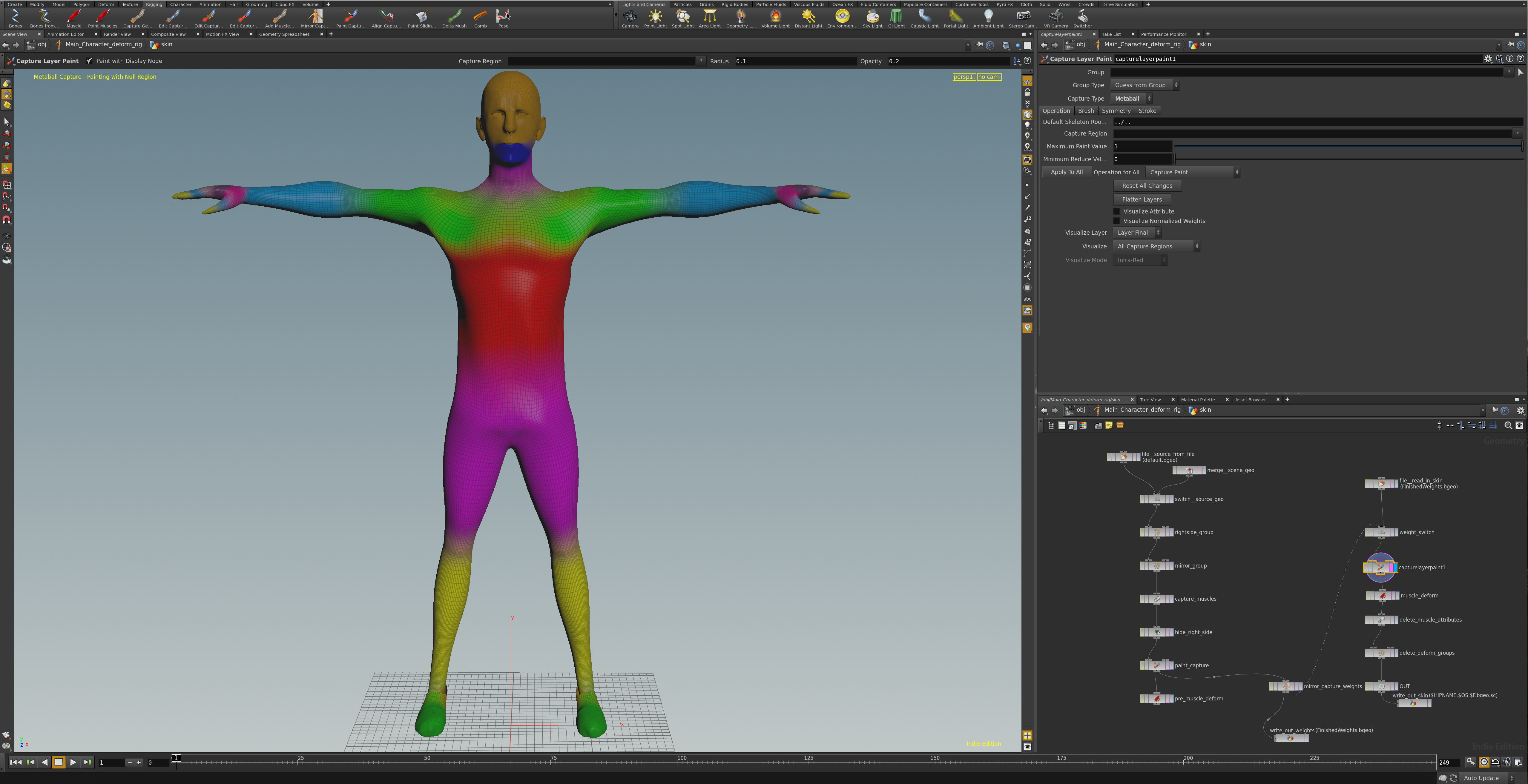

8171 posts
Here's the screenshot of how to do the Attribute Transfer using your file.
