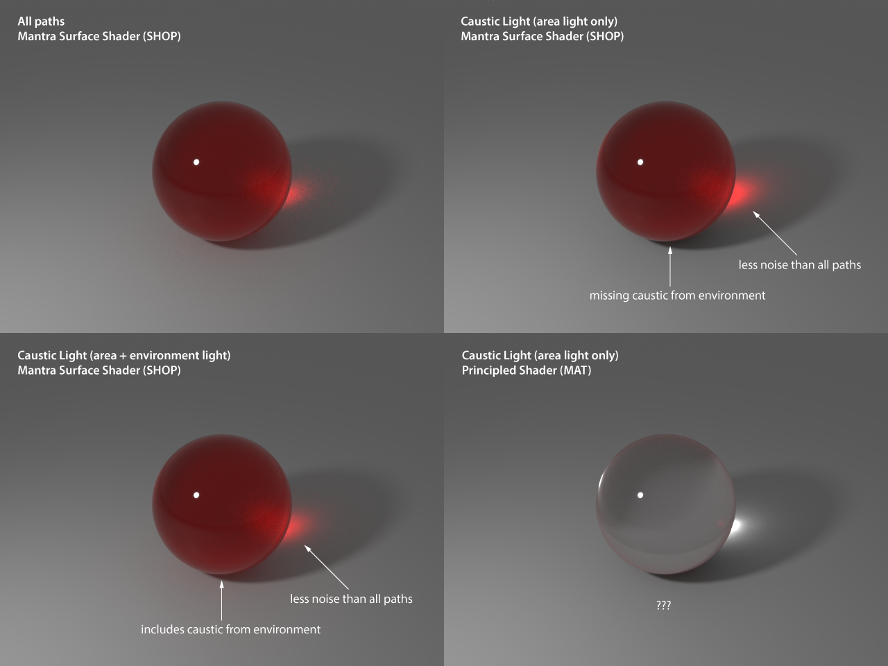

Hi, I decided to setup a test file to help explain and also ask a question related to transparency/caustics.
I very rarely use faux caustics but it depends on the scene really. For something like this example, I've used All paths and compared to photon maps. (caustic light)
All paths can be found on the Mantra render node on the Rendering > Shading tab, Allowable paths. This allows you to render caustics without using photon maps but it tends to be noisy.
Using a caustic light to generate photon maps will produce less noise but will take longer. You can reduce the time by using the Light Mask section and removing lights. (I've shown this on the example picture)
I've used the Mantra Surface Shader (SHOP) as that's what I'm used to. I tried using the Principled Shader (MAT) but as you can see from the result, the glass is not red and I'm unsure why. I'm sure that I'm missing something and I'd be grateful if someone can explain.
Rob

487 posts
Joined: Sept. 2016
Transmission colour (and nested dielectrics features) on the principled shader will not work in “Physically based rendering” mode unless you enable it explicitly on the mantra ROP (rendering->shading->“enable absorption and nested dielectrics”).
It doesn't seem to affect the colour of photon maps however - that might be a bug. I'll file a bug report.
240 posts
Joined: March 2015
Thanks dlee, that answered my question and produces expected results similar to the Mantra shaders above.
