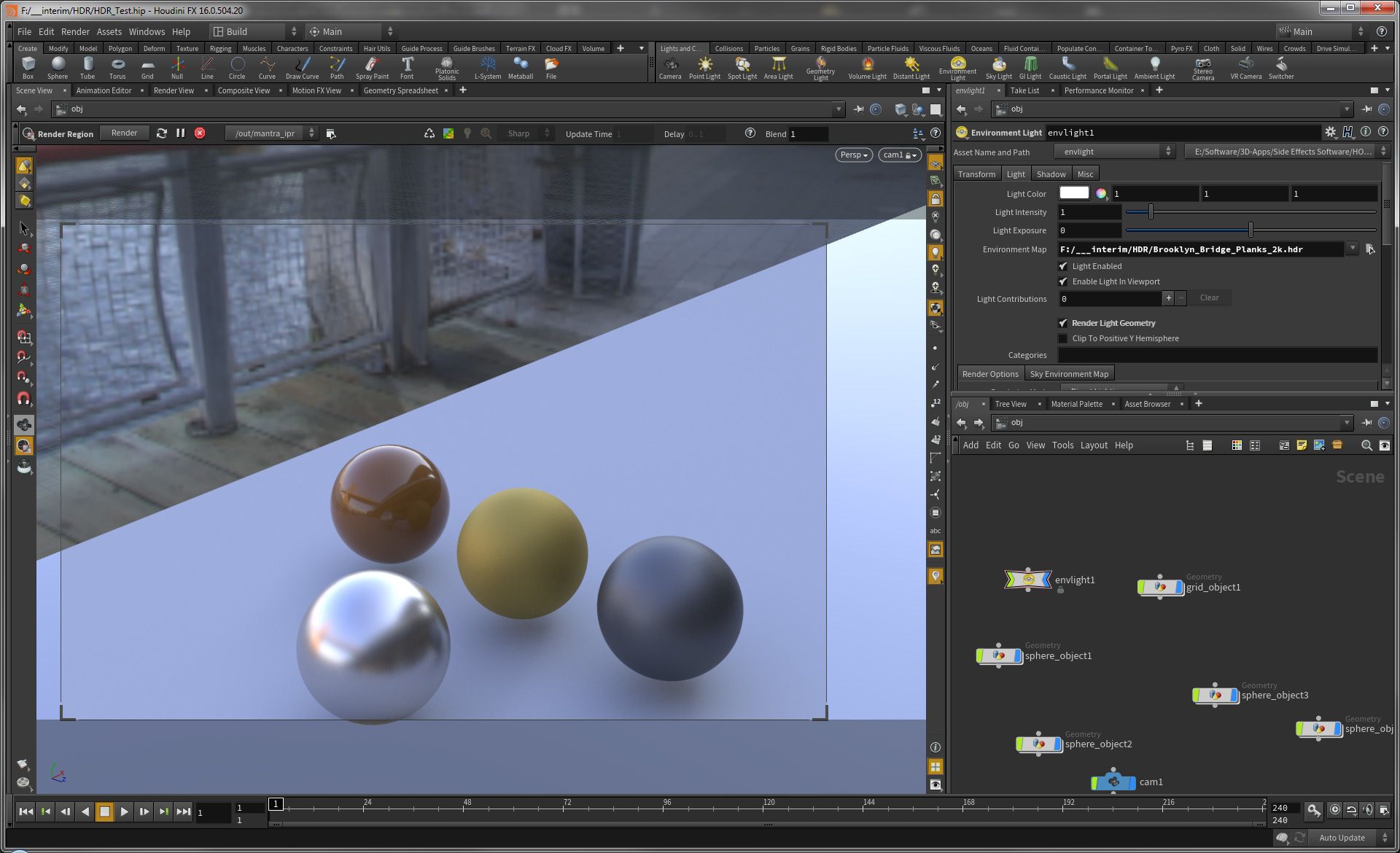

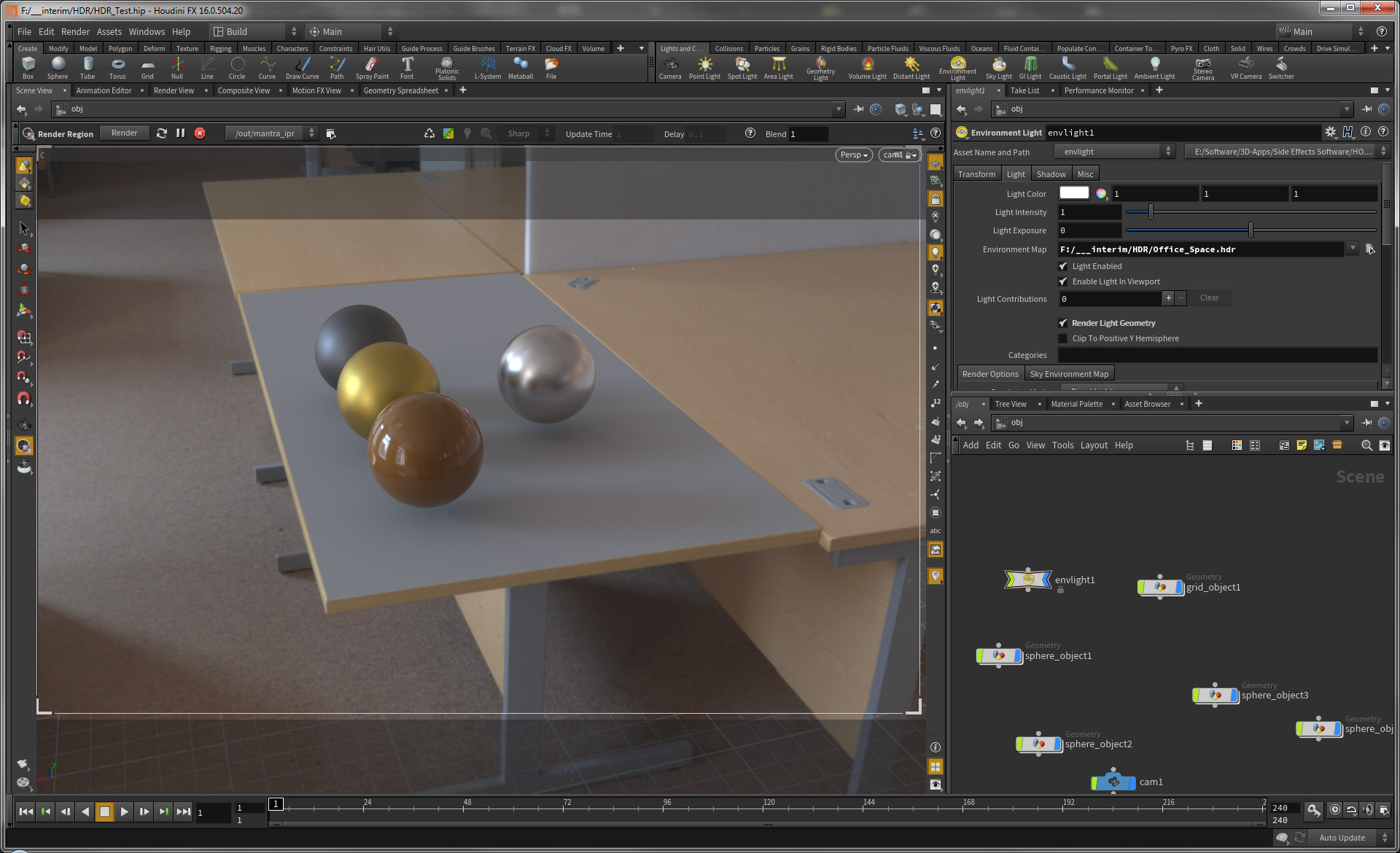

Hmmm, everything fine here…
simple environment with hdr
maybe wrong gamme:-?
or if you exspect more contrast,
then use a COP with brightness curve?
Its simpler to detect your problem, if you attach a file :-)

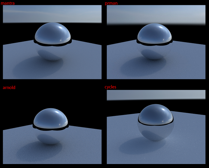

It's interpreting the hdr values correctly as far as I can tell. The hdr files themselves don't seem to have any custom primaries either, at least not in the samples. I suspect that the values you're used to seeing is after tonemapping (the preview images on cg-source seem like they're processed).
Mantra (like most production renderers out there) simply apply gamma by default. You can try custom LUT in the viewer or try different OCIO profiles (on final rendered output, of course) until you find the one to your liking.
edit:
I did some comparison renders to show that all renderers including mantra interpret the HDR file the same way.
You mentioned on the other thread (https://www.sidefx.com/forum/topic/43521/) [sidefx.com] that Cinema4d renders it differently - I don't have access to Cinema4d, but it's possible that it's applying some custom look/display transform out of the box.

matthias_k: Thanks. Those were very helpful.
Rosko Ron: It seems clear that mantra interprets hdr the same way as all the renderers we've tried so far (prman, arnold, cycles, clarisse, cinema4d, whatever's built into Modo…), so there doesn't seem to be an issue here.
My recommendation for you is to ask cg-source directly and find out what kind of tonemaps or post-processing they're applying to the images, and use those to get the desired looks.
