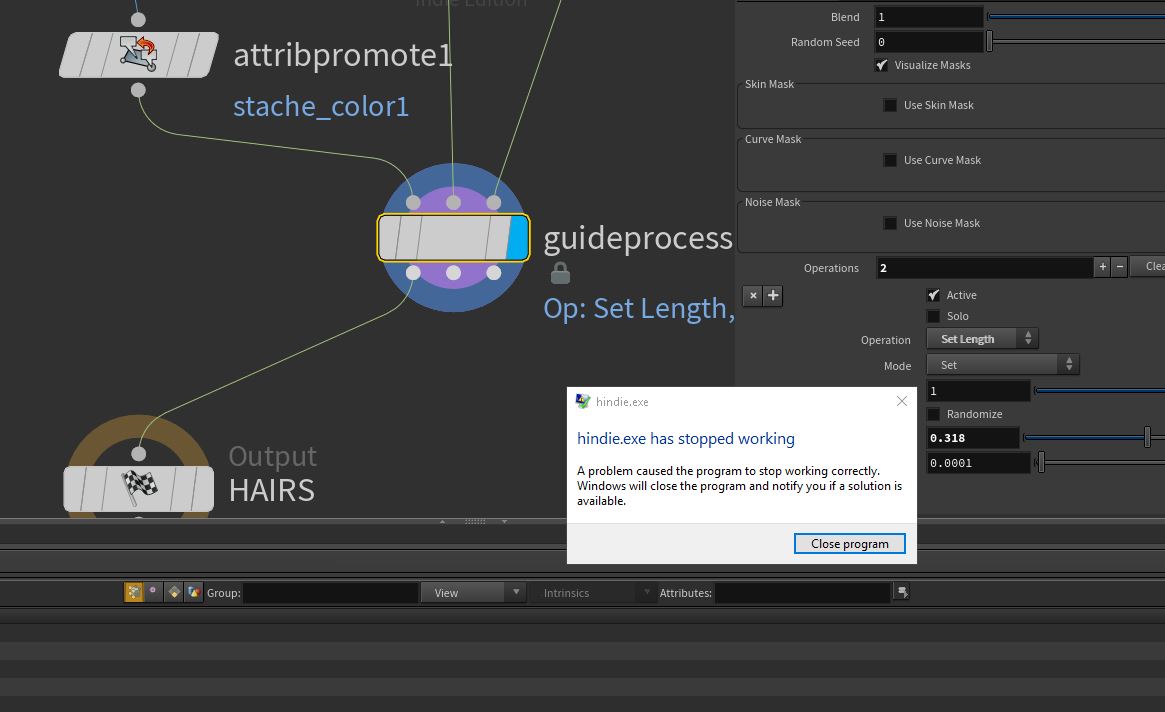

Thanks man. But like all great patch ups and work arounds, it came with its load of unexpected extra issues
With the carve node in there, any changes upstream in the hairgen after that, for instance adding guideprocess “set length” and then scroll the timeline will crash Houdini.
I'll have to wait for a new build i think.
