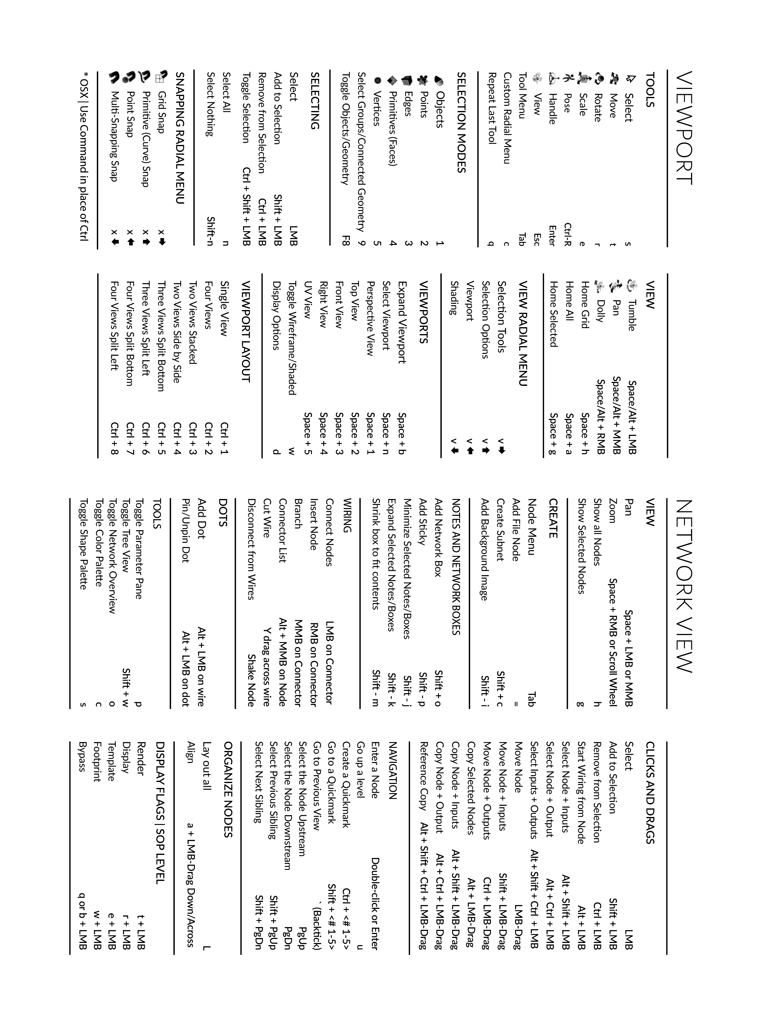

Is there somewhere a list of all the houdini 16 shortcuts? I want to know what are the unused keys in the various menus which keys i don't know and so on.
I saw the hotkeys include list which has about 50 files associated. A bit too many to go through
1342 posts
I am looking into whether or not a complete list can be created. Until then here is a wallpaper with some of the main Shortcuts:

That's better than nothing . Thanks Rob!

8178 posts
Joined: Sept. 2011
Is this available in mousepad form?
Joined: July 2018
… Printable version?
( I mean white background… )
340 posts
Joined: June 2017
Here is a printable version. I changed a few keystrokes, because on my iMac with the most recent OSX, a few commands using the CMD key in the pdf above are really assigned to the CTRL key.

29 posts
Joined: May 2018
DimaVJ
Houdini Keyboard Shortcuts Black on White.png (352.8 KB)
