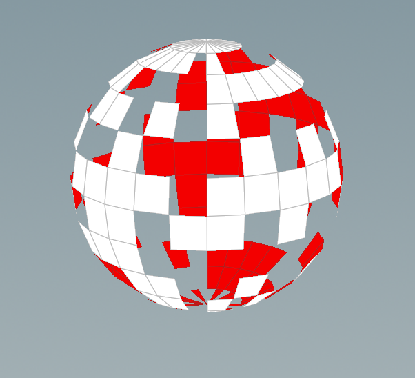

would you mind elaborating or making an example how to do this?
Im not sure if I got ur method right.
Thanks
backface.hip (67.7 KB)
