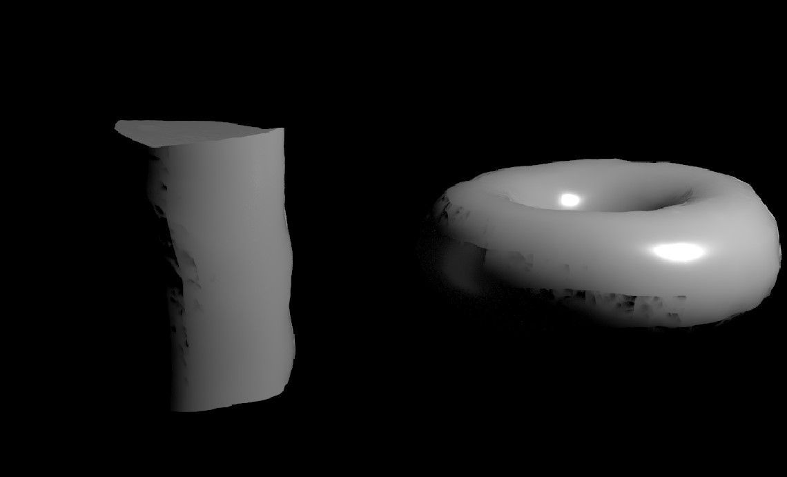

I think you may be correct. But I've had a lot of issues getting to grips with displacement in mantra. I'm coming from Lightwave, so my experience there is that displacement just moves around whatever points you have, be that an unsubdivided mesh or a subdivided one.
And then I also tend to run into issues when I try displacments (see attached images). In this case, do I need to recalculate normals myself, or does mantra do that?

The N connector on the displacement shader is where the recalculated normal should go. It is up to the displacement shader to do so. Although it is generally as simple as using the ‘compute normal’ node.
