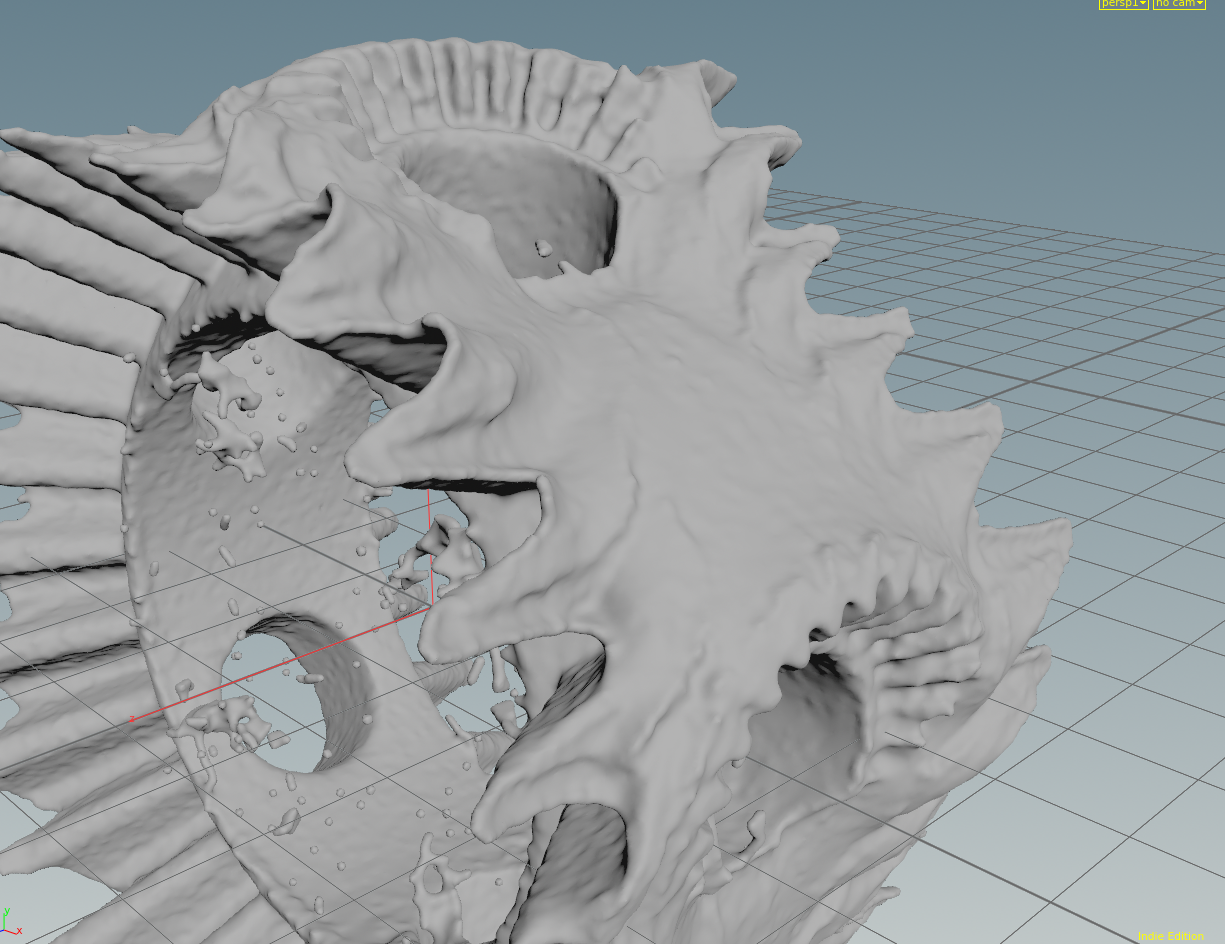

Attached, in comparison, is the level of berming/swell I was getting back when I started this adventure; it looked great, but lost volume over time, which is what sent me down this path to begin with.

How far did you lower the magnitude? I ran at 0.02 separation & turned off equalize for testing how the gravity waves propagate. With the slow motion of a single cog + 9.8, things stay very flat as you experienced. Dropping two orders of magnitude to 0.098 and I got waves forming in front of the moving spoke.

Ah, I indeed see that. I guess I was hung up on 1) the fact that a magnitude of 9.8 gave me some nice shaping when using sourceVolume colliders, and 2) I tried to model this whole thing in a reasonable space (a few meters), thinking that using real-world values would yield results that looked appropriate to scale. The latter is, unfortunately, a habit I repeatedly have to shake doing water stuff, I've noticed.
In any case, mostly I wanted to confirm I wasn't still doing anything ‘wrong’, and that this force magnitude knob was indeed the right one to be turning. Lowering it an order of magnitude does indeed give me lots of nice splashing, which looks totally great. This sim is also running fast enough for me to iterate in a more artistic way now, which is great. And, the best bit is, I've learned more about the FLIP solver in the past week with your help than I managed to over the course of several years working in a large studio. So, a thousand thanks for all your superb help! I truly appreciate it so much!
