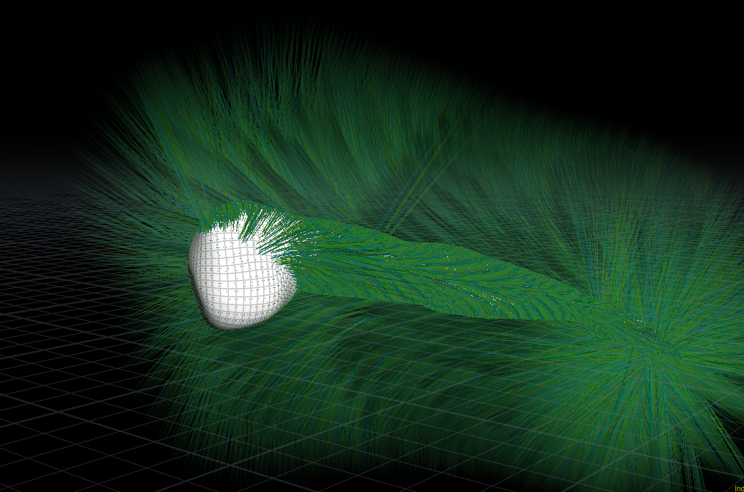

I'm still confounded at to how the collision detection is failing so miserably. So I have the static object radii in green, and the cloth's in blue. If you stop and scroll the video in the beginning you can see the cloth is falling at about an inch per frame. There are 4 substeps in between those frames, and 2 collision passes. Could anyone please explain to me what is happening exactly at these substeps and what these collision passes are doing? Because they are somehow failing to stop the cloth from penetrating deep into the arms. I watched the cloth masterclass, and there is that part where they show the ball moving through the cloth and how on two consecutive frames it is on opposite side of the cloth but because the solver can interpolate positions between frames it catches the collision anyway. How is that solver the same as the one that is doing this!

454 posts
Joined: June 2007
I'm suspecting that the winding order of your collision geometry may be reversed.
If you display the default-generated normals in the viewport, they should be pointing outward.
You can use a reverse SOP on your collision geo to see whether that fixes the problem.
About explosions with collisions: there was a friction-related bug for cloth that caused instability.
This should be fixed in 16.0.776 and newer.
The number of collision passes that you want to use depends on the complexity of the cloth sim.
Depending on what you're doing, you may need to go as high as 8 or 10 for this.
47 posts
Joined: Dec. 2016
Michiel,
By God, you're right! The normals are pointing inward! Ok, in all fairness though, I did check this quickly before and I thought they were ok because I saw normals everywhere. Very, very, very long normals. I didn't realize that they were simply so long that they were oriented inward but just poked all the way through the mesh and out the otherside! Ok, I will reverse them and see how that works. Thank you very much Michiel.
By the way, is it a problem that they are so long?
Edited by mbbuckley - Nov. 2, 2017 11:30:17
454 posts
Joined: June 2007
The sim has no problem with the normal vectors appearing this long.
You can scale them down in the Display Options under “Guides”, by entering a lower value for “Scale Normal”.
I recommend doing this scale down, because when you display long normals, they may appear as if they're pointing outside when they're not. This is particularly tricky for convex shapes.
