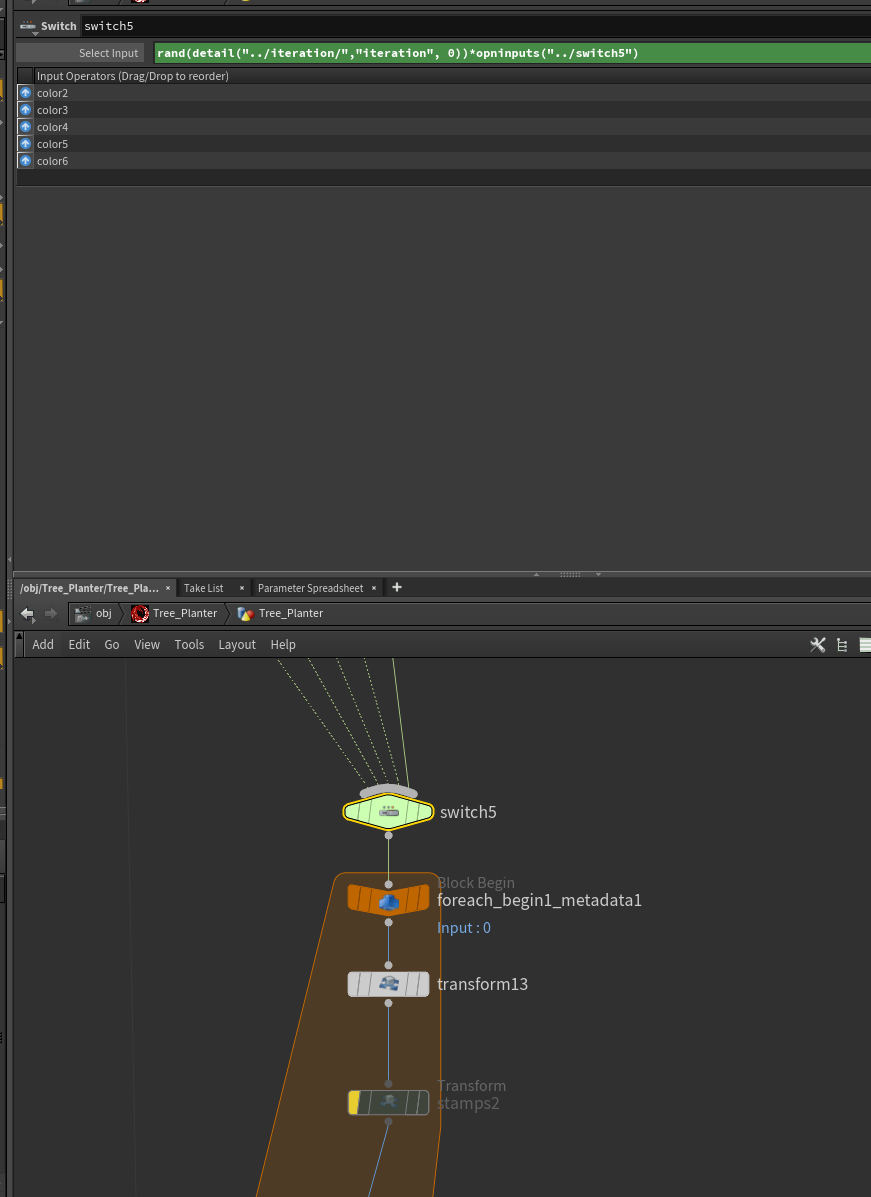

I was looking at this video earlier. So I have things kinda working.. i have random scale, rotation.. and even object selection.
What I don't have is any control like I had before. The Stamp function sends an attribute up stream. I am scratching my head about how to put the $ID value into the switch node.. basically copy mesh #5 when there is a point attrib of ID#5.
Like I do with stamp(“../copy4”, idval, 0) on my “old” copy stamp setup.
