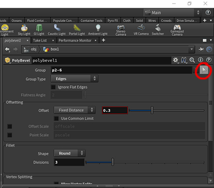

Hi, thanks for your input. Before I start looking into my system/drivers, I just want to make sure I've been clear on the “viewport selector”. (I'm not sure what it's actually called) I've attached a screenshot of the button I'm referring to.
If it still works on yours, I'll have to look into what's causing it on mine.
