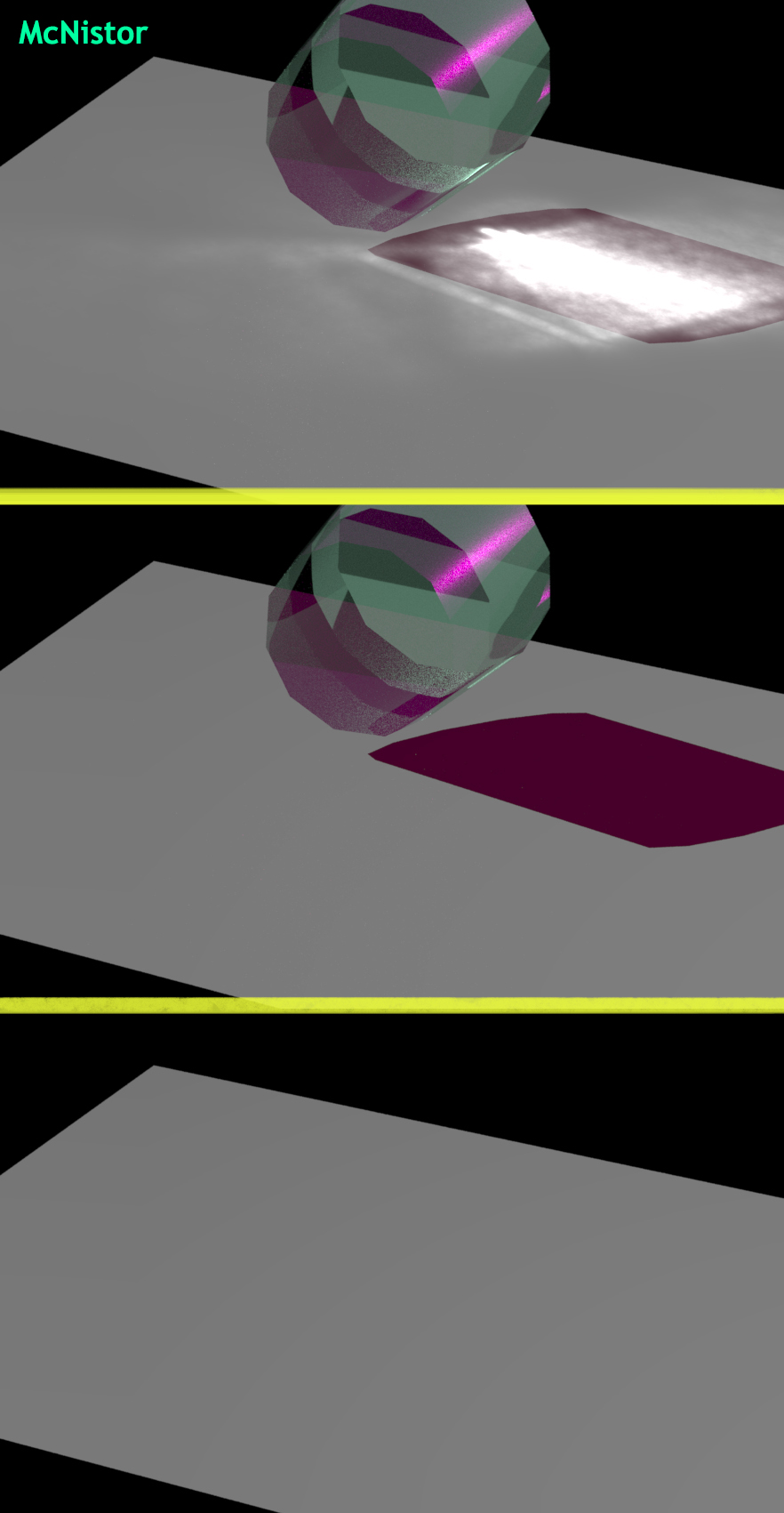

Have you downloaded McNistor's file (my_caustics.hipnc) and tested rendering?
How do you render - in your file (tamingcaustics.hipnc) mantra_ipr gives an error. (?)
Try to do the following:
1. Do rendering with the McNistor's scene and add screenshots/ file if you'll have errors/ caustics will be still in place with deleted tube.
2. Add a camera to your current (tamingcaustics) scene and render again > with all objects and lights; without caustics light; without tube.
Probably you'll need to submit a bug.
*on the second of two uploaded by me images (McNistor is written at the top left corner) > the upper of three pictures - scene as it is; the middle picture - without caustics light; the bottom image - without tube object, but with the caustics light.
Edited by ryuku - Jan. 13, 2018 06:22:57

I did rendering with the IPR that had the default ROP Camera. Question, why does everyone else's purple tubes also look green?
8191 posts
Joined: Sept. 2011
McNistor's version is green/purple because the material has a colored opacity. Opacity is not typically used for glass materials, except for fake glass for real time renderers
The transmission color is the parameter used for tinting glass on the principled shader.
Try increasing the number of photons to around 10 million for a smoother result.
