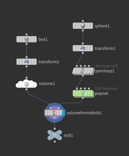

Hi Everyone,
I'm trying to create a volume that takes its density and color from particles. The particles are emitted from a sphere and take their color from it's surface, which is blending between red and blue. I'd like to render this as smoke.
I've been searching for a solution to this, and while I've come across a few threads, I'm yet to find a working solution.
Based off what I've read however I've arrived at using a Volume from Attribute node to create the volume, and followed by an Attribute Transfer to bring the color across from the particles to the volume.
What I'm finding is that the pop net is only outputting a single Cd value, rather than values for each particle. Resulting in the volume in a single color.
I feel as though I'm missing some logic in how to achieve this… I've attached the working file and any feedback would be greatly appreciated!
Thanks
ColourVolumeFromParticles.hipnc (259.3 KB)

Attribute transfer is for geometry attributes, not voxel values. You'll need to use a volume tool to achieve what you are after. Volume from attribute should be able to create a color field from your particle color.
but VDB's are better.

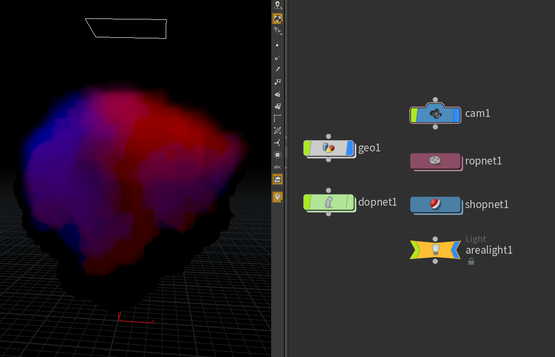

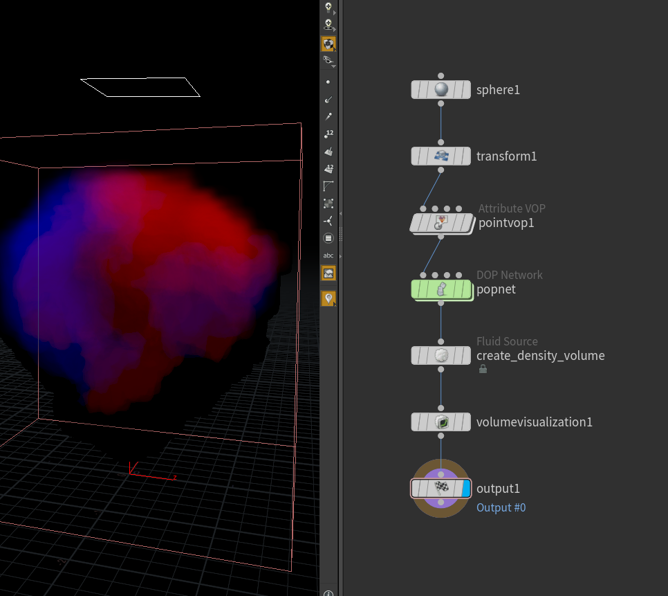

Hey guys,
So I've dug through a few more threads and have now tried a different approach.
Using a Fluid Source node it seems like now at least the volume is drawing in the Cd values from particles. This is only visible when followed by a Volume Visualization node, with Diffuse Field set to Cd.*
However when I then try to render the volume with Mantra, it has no color.
I'm not sure why the Cd values are following. Again thanks for any tips or suggestions that could help!
Edited by starion83 - Jan. 19, 2018 13:18:57
ColorVolumeFromParticles_2.hip (812.0 KB)

Here is an example file with a few methods illustrated for creating density and color fields from particles. The preferred method is probably volume rasterize particles combined with vdb from particles for the color, or a volume rasterize points. The volume from attribute node only works with traditional houdini volumes. The benefits of vdb include not determining the bounds in advance, memory savings allowing for increased resolution, and the general speed of the vdb library. Some of the nodes for working with vdbs will even create extra fields as needed.
volume_from_particles_example.hip (697.3 KB)
