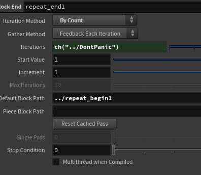

so is there a way to access a detail attribute to use in something like a for loop?
if i were to make an attribute called “DontPanic” i can call it in my forloop like this:
is there a way to access the objects details to get a value to feed into here?
thanks
thanks

thanks much everyone, please excuse my ignorance it's only my 30th day inside houdini and the learning curve is a bit on the steep side. I am chugging along but sometimes i hit things and its a wall. Part of the problem is i dont know how to formulate my question, as y'all have your own “houdini speak”
thanks again for the help, I hope ot pay it forward.
in case others stumble here…
another houdini user at work helped me out and this works:
detail(“../NodeIMadeTheDetailAttributeWith/”,“DontPanic”,0)
