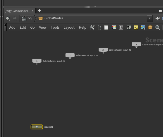

i have been through the foundations book and i am perfectly able to make a terrain and get it into unreal (in multiple different ways) the issue is the other way around.
I can manually export everything but the dimensions dont match up.
And everybody says that we should do it with the Houdini Engine plugin (seriously i read this thing on 5-6 separate occasions) but no one really tries to explain how its done.
Also as i explained i really don't get how it describes to do inputs. I really don't get it. Maybe it makes sense when you know what to do already. But as a beginner this help file doesn't tell me anything. A simple picture that shows the correct node network would help.
PS: I also got an input to somehow work but when i input the landscape and click “send it to houdini” an empty scene comes up with a bunch of nodes that throw errors.

Hi
Sorry about that, I should probably mention that bug in the docs:
There is a currently a bug when saving the debug hip file, that causes the HF Merge and VolumeVisualization node to be disconnected.
It happens only in the debug hip file, in the internal unreal scene, those nodes are actually connected properly.
Seems to me like you got that input setup properly.
Here's how input should be created:
Assuming you want to make a very simple HDA, that just puts noise on a HF.
Your network would look like this:
Heightfield -> Heightfield_Noise.
To create a SOP input, select the HF Noise and create a subnetwork for it (the box icon).
If you dive inside the subnet, you'll see that the HF Noise node is connected to an input that was added when creating the subnet.
Those are the SOP inputs mentioned in the docs.
You can then create an HDA by right clicking on the subnet, and choosing Create Digital Asset.
When importing this HDA in Unreal, you should have an input in the details panel.
To create an object merge input, assuming you have the original setup (HF > HF_Noise)
Delete the HF node and replace it by an object_merge node.
Create the HDA on the geometry node.
In the parameters of the HDA, you can mark all the preexisting params as invisible.
Then drag the Object1 (objpath) parameter of the object merge in the parameter list, exposing it at the HDA level.
Save the HDA, and when importing that HDA in Unreal, you should also have an input in the details panel.
Let me know if you need more info on that.
