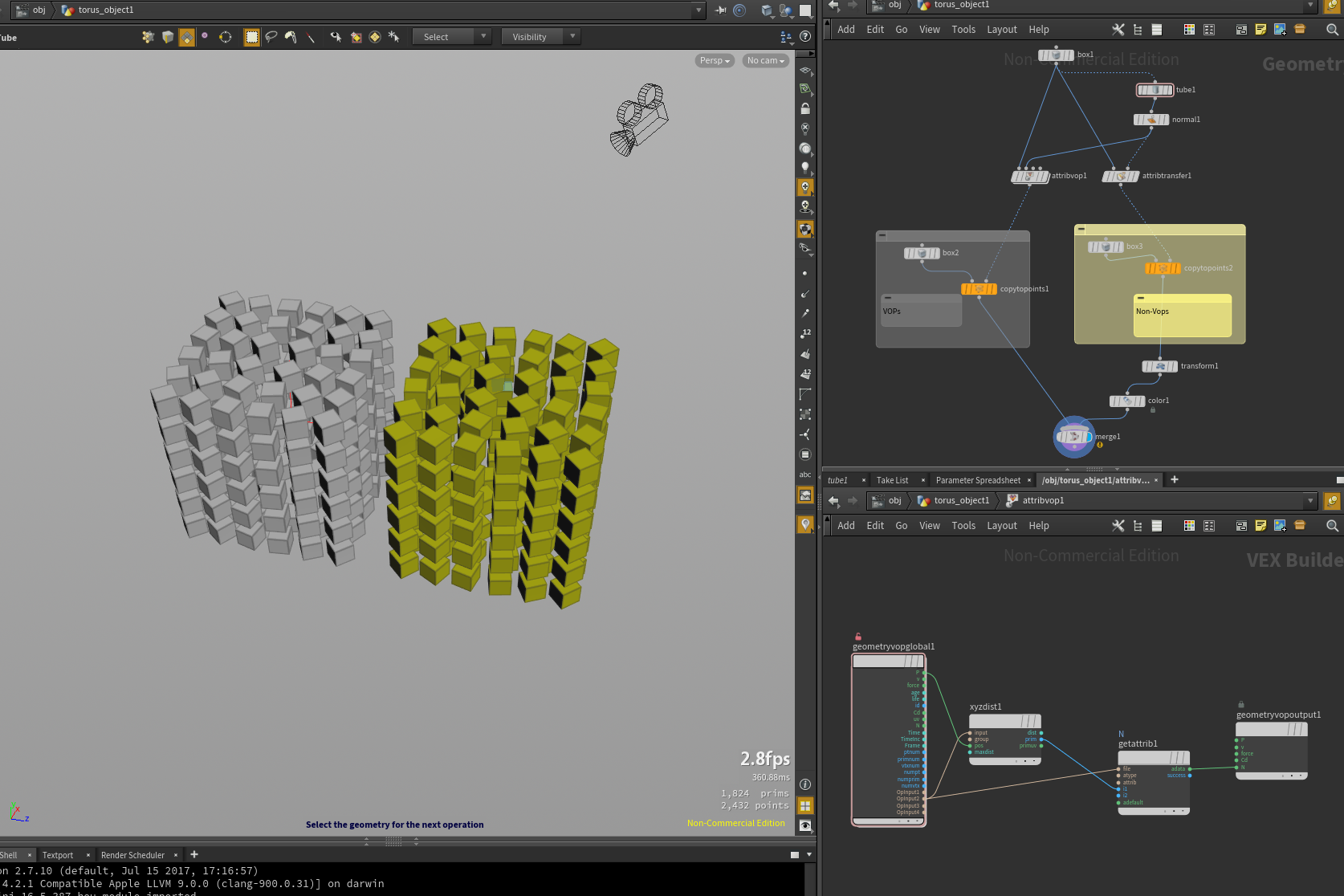

fuos
Here's another version with attributeVops, though AttributeTransferSop(in yellow) is probably the easiest solution. Hope it helps.
Great stuff, Fuos, I really like the transfer attribute approach, also the simplest and the most flexible, it gives a little more creative options when playing with the transfer attribute conditions. I'm definitely going to remember that one, very handy. Only really used the transfer attributes to transfer colors so far and that was a bout it so it really didn't cross my mind to use those for normals. But it makes a lot of sens to go for that method.
