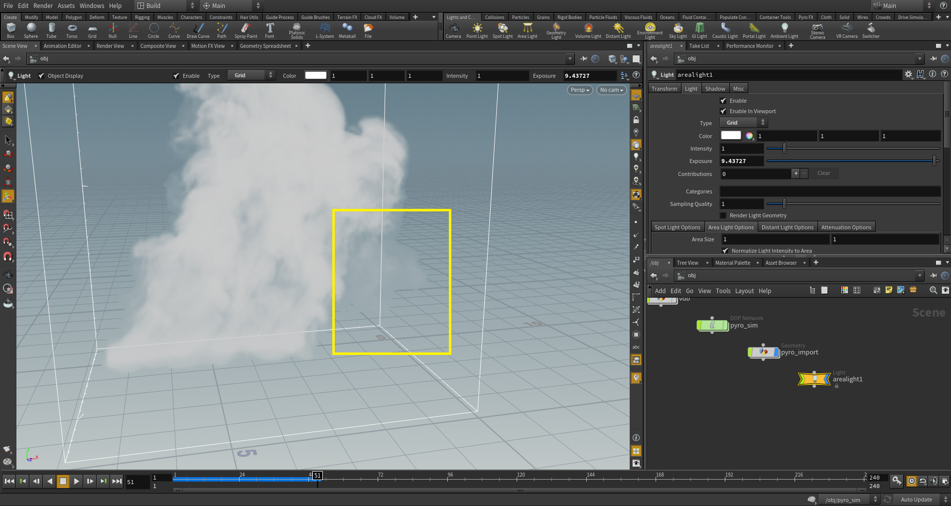

Hi all, I am a beginner on Houdini and I am currently having a problem with the VDB. On my rendering I have a lot of small pixels, and on my viewer I have a kind of blur, I tried to increase the “division size” (0.05) but it did not change anything. I will need your advice! thank you !

Increase the stochastic samples to around 10-12 samples from the default 4 (if I'm not mistaken).
You can read more about reducing noise in Volumes from the docs. http://www.sidefx.com/docs/houdini/render/volumes.html [www.sidefx.com]
Remember that the volume visualization in the viewport are often not the final representative when you render it in Mantra as it depends on the Pyro shader setup.
