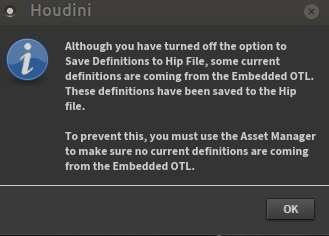

Am getting this annoying pop up warning every time I save my scene. Opening the Asset Manager doesn't offer any further clues as to which OTL is the issue.
Anyone else deal with this?

When you open Asset Manager you have to open up and look through the subfolders to find the Embedded Folder.
3467 posts
This indicates that you have Save Definitions to Hip Files OFF - the default, but that one or more HDAs in your scene is Embedded.
Open the Asset Manager : Assets > Asset Manager
then open Operator Type Libraries > Current Hip File
you'll see a section called Embedded
inside are the HDAs that are being saved to the hip file

This warning popped up after i opened a scene from 18.5 to 19.
What problems can this cause?
In order to fix this i have to go to every embedded otl one by one and change it?
