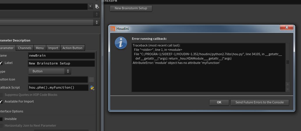

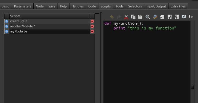

Trying to configure a digital asset: I want to run a callback script for a button parameter. The callback should call myFunction() from the one of the python modules that I created in the “Scripts” section of the Operator Type Properties.
I get the following error when I press the button parameter:
AttributeError: ‘module’ object has no attribute ‘myFunction’
Any idea how to setup the callback script?
Thanks!!
ps. I've already searched forums and looked at relevant doc, but probably I'm to new with python to understand everything.
callback error.JPG (59.5 KB)

ok finally found what was wrong.
I spent two bloody hours on this dumb thing.
For future generations:
THE NAME OF THE MODULE MUST STRICTLY BE: “PythonModule”.
Don't change the name of the module (like I did) if you want to use this simple callback script for your paramater:
hou.phm().myFunc()
that calls the function myFunc() stored in your module in the Scripts section.
