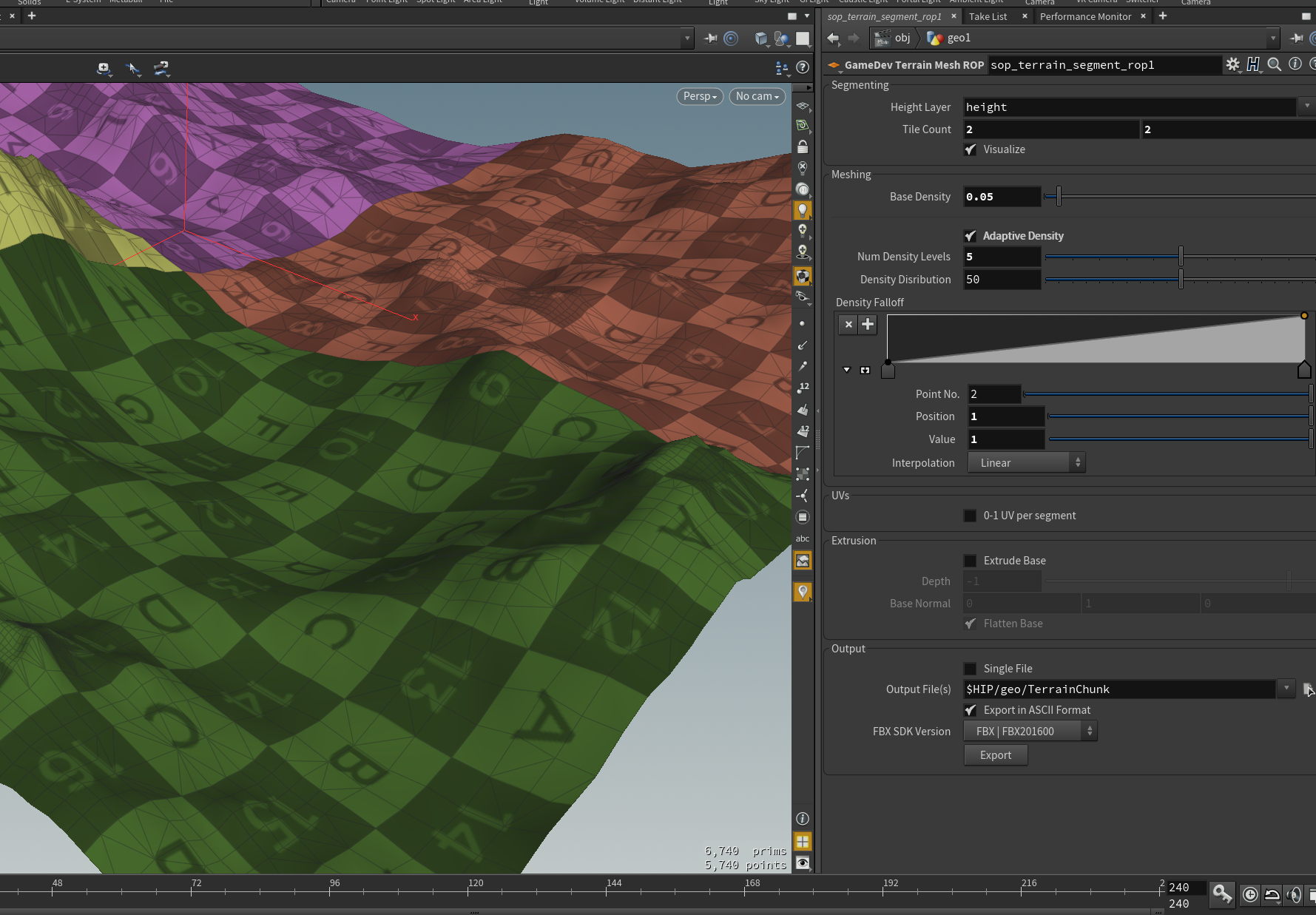

Hi, I've been looking into converting our UE4 landscape into mesh, being new to Houdini this has been a very exciting journey (I might have some more questions later)
However I have noticed that the terrain chunks crated using the Game Terrain Tools have holes if adaptive density is checked, this all works fine in Houdini 16.5 but not in Houdini 17, see bellow.
I wonder if this is something on my side or on the Game Tools side?
Thanks!
Houdini 17:
Houdini 16.5:
Edited by TomVee - Nov. 21, 2018 04:48:42

That is supposed to work with the settings you're using.
I will look into this issue.
Paul

I was able to reproduce the issue and have submitted a fix.
It will be fixed in build 1.84 and newer.

That's fantastic, thanks! I can confirm it's working with Game Tools 1.84
