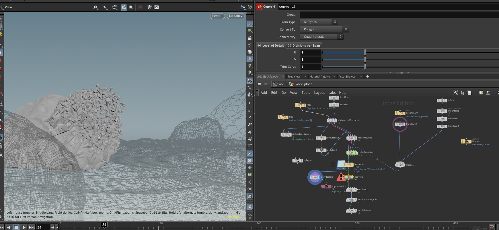

I am at this step now as well.
Fractured an object using RBDMaterialFracture >ran object through UV process before it gets to RBDConfigure>RBDBulletSolver>FileCache
So now I have this pretty nice sim in FileCache that refreshes decently quick in Houdini but every attempt to get it back into Maya crashes Maya on import. Like... it doesn't kill Maya but rather freezes it up indefinitely.
I did successfully get a sim out of an earlier iteration of this using the convert node before the alembic ROP but that takes a very long time. About 13 hours to convert the whole sequence. Using Convert All Types to Polygon.
But for some reason this new iteration isn't successful in creating an Alembic that Maya can import. The Earlier iteration that worked didn't have UVs for the inner pieces and this version does. I can read the UVs if I preview the convert node after the File Cache. So they are transferring across the node network. Just need a way to make an Alembic that is usable in Maya.

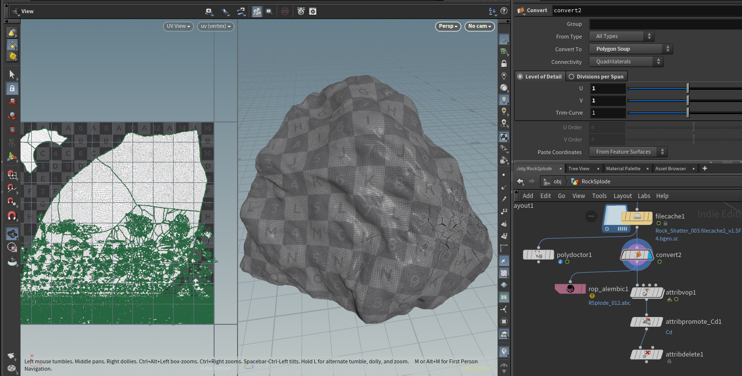

Switched convert node to From Type "All Types" and Convert To "Polygon Soup" and the alembic successfully makes it into Maya.
Scrubs pretty nicely as well. BUT... no UVs
I can still see them at the Convert node and the other nodes to test. But just ran from Convert to Alembic Rop to try and get it out to Maya. So It does make it to Maya but no UVs. Any idea how to force the UV attribute into the Alembic file?
